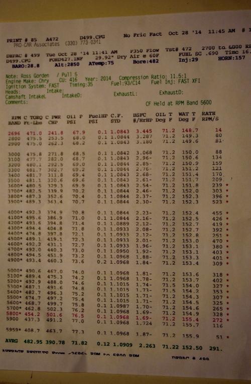

Got to see his dyno sheet (secret) and a couple of other tricks (secret) so soooo.....after the blood
oath, I can't really tell you anything.

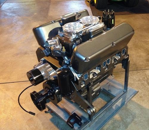

Secrets? Only on a couple of the interior parts...and not really secrets, I just don't want all my ideas "borrowed" before I get on the road. As far as the motor, no secrets here...Max torque @4100 RPM 495.6...Max HP @5700 502.3. Here's a couple more of the little motor, I still think I'll change the color to something closer to the stripe color

When I painted the Transmission and fuel cell I had the stripe color made in a enamel and sprayed it with my HVLP gun but it was much darker than the stripe I'll work on it today and figure something out .
I Just had to repaint the Motor and Wow I'm really glad I did, It turned out much better than I thought it would, I was worried about it being to dark and hide the details and contrast. I went and got the exact same Base/Clear that's on the Stripe, no variation this time.

I probably have said it before but i will say it again.That ride is going to be BADASS.
is that gonna be the grille color too?
Yes it's currently matte black with granite grey inserts but it's gonna get scuffed and repainted. You were referring to the Sharktooth grille not the other one I had dad pick up at the Nationals?
