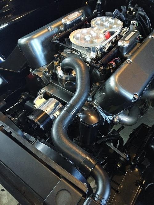

Upper hose looks better with the AL shortened. My only concern is that vibration may cause the AL to work harden and crack. Otherwise, excellent fabrication work as usual.
Regards,
Joe Dokes
I had the same thought, not quite comfortable with that length of metal tubing, engine and road vibration...
Of course I could be completely wrong.
Regards,
Joe Dokes
I had played around with making a support that tied to the top of the radiator and the aluminum tubing for support but since I shortened it quite a bit and the radiator is Rubber mounted for Vibration and the motor mounts are isolated with rubber bushings and shouldn't "Flex" much, I should be alright.
I picked up the Radiator from the local Radiator shop and then painted it with Eastwood Satin Radiator paint and assembled everything hopefully for the last time and bolted it in.
I like the finish and overall look especially with the Black hose ends. I also picked up a set of Hi-lo horns and decided to mount behind the left headlight bucket since like everything else I wanted them hidden...mission accomplished. Enjoy
