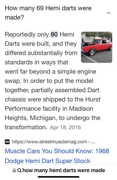

Muscle Cars You Should Know: 1968 Dodge Hemi Dart
A REAL 68 hemi dart or barracuda (your example) is a high dollar car. I agree with you, I like cheap fast cars. I had somewhere around $9000 in this 9 second car.....
