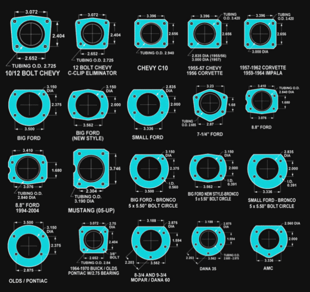

Also note the difference in the stamping and the bolt spacing and center hole compared to A body 7 1/4 and 8 3/4 10x1.75 backing plates

Axle Flange Housing Identification
