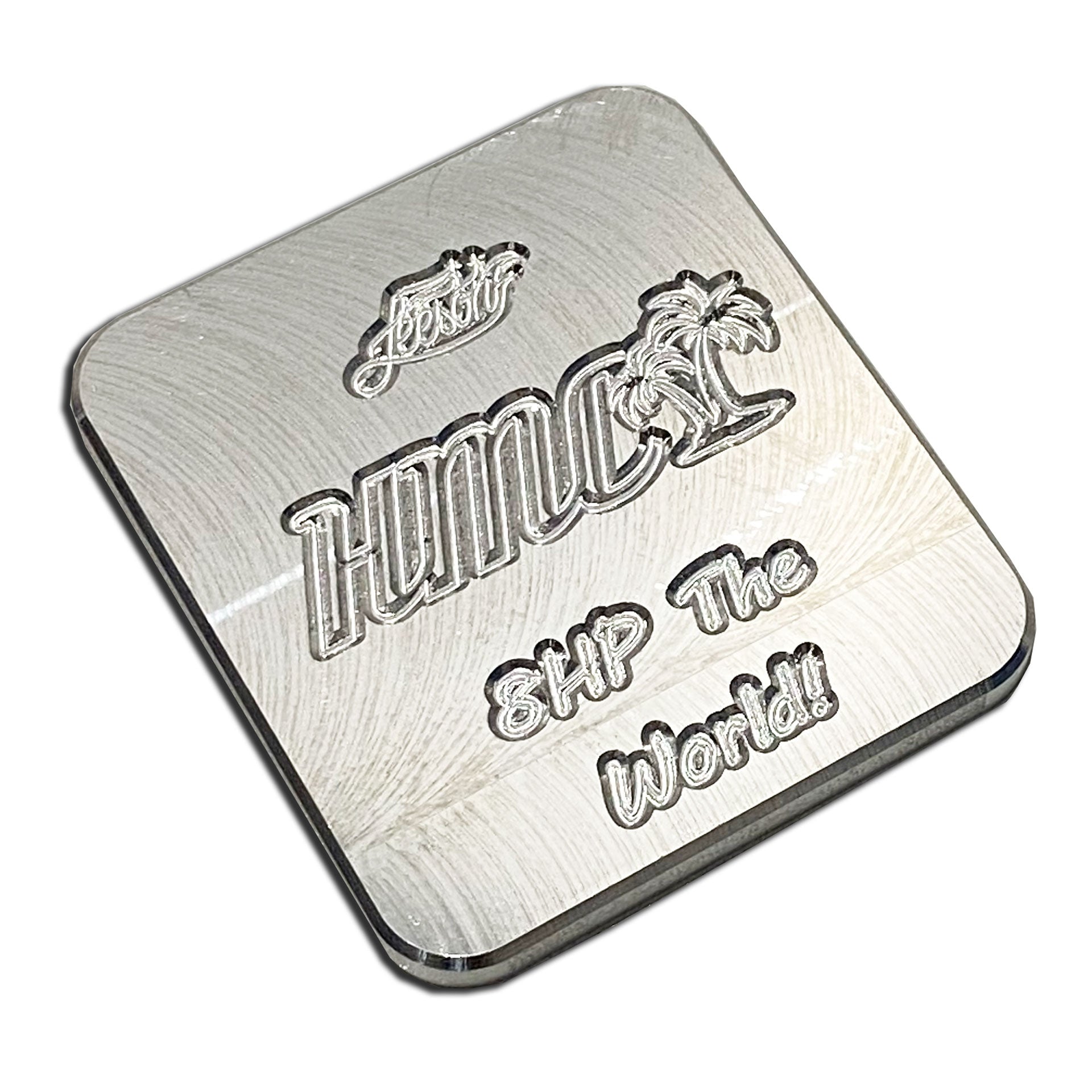

BTW, 8speed.au does sell the cover they had machined:
