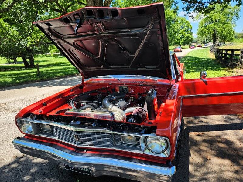

Well, I made it to the Hot Rod Power Tour today, mostly without incident. The last 3 miles to get in was way backed up and apparently my fan decided to blow it's fuse, so the radiator ended up puking. Waited half an hour or so and it cooled down enough to limp it the rest of the way there. The way home was no problem since I was able to keep moving. I did get another fuse and it blew immediately, so need to track down that issue.
I can't count how many people in line offered help- truly a nice bunch!

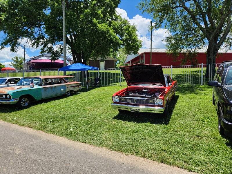

Found a nice shady spot at a local car show near my folks' place and spent several hours catching up with a close friend I hadn't seen in person for almost 5 years... Great day! My buddy won a trophy with his 53 Ford Pickup- I took a big L! Lol

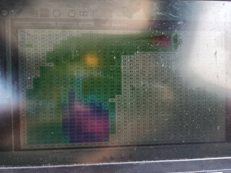

Had an appt with a tuner today. Spent the first good while working on fueling while driving on the street. It was apparently running pretty lean and there was a decent stumble in the higher rev range. Below is the fueling chart he ended up finishing with. Purplish stuff in the bottom right side is decel. Green is all looking pretty good. The orange/pink area is something he manually adjusted to overcome the high rev stumble we were experiencing.
Unfortunately, it doesn't seem that my timing control is working at all as any changes he made on the laptop were not actually changing on the engine/running. We waited on the phone about an hour to get to Holley Tech support and they ended up saying that timing control just won't work with the Sniper on my application. Tried sending me over to the MSD side to talk to them but after waiting on hold a while we gave up on it.
At this point, I need to figure out why the timing control isn't working and get that rectified and then probably go back to the tuner again so that we can do that portion. At this point, we didn't bother loading it on the dyno as all we'd really do is convert money into heat and noise just to get a low number.
We did try advancing the timing a little bit by rotating the distributor, but then my idle got much worse, so moved it back.
