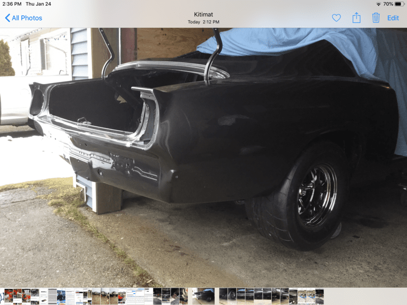

A few pics of barracuda project.

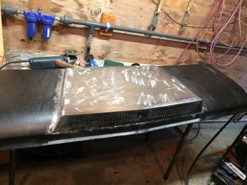

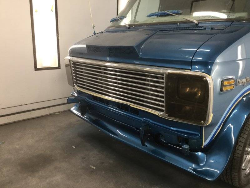

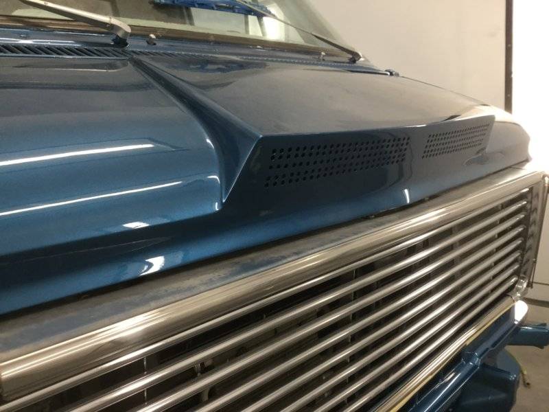

Not for my car, or any car for that matter. Had a guy wanted me to make this scoop for a old Chevy van. He had the van since high school, gave me a cardboard mock up of what he wanted. This is how it turned out.

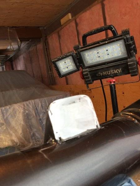

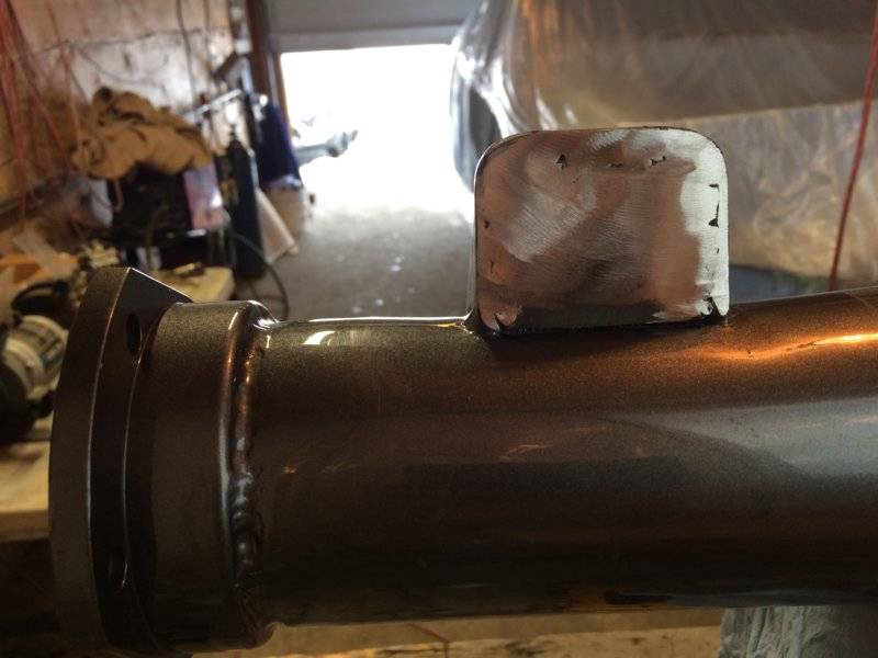

Welded my spring perches closed as suggested by
No jig, nothing will move, easy upgrade. You could fab up a nice fitting gusset in there, your just keeping the rear of the perch from crushing. Just a paint touch up afterwards. And if your not running slicks you likely wouldn't have a problem anyways.

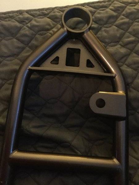

I didn't notice a drivershaft hoop under your car. I built this one. It tied and made the car noticeably more rigid. Can't wait to see that Barracuda finished, love the spoiler work you did.

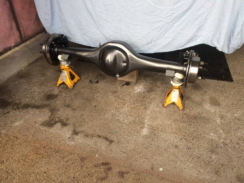

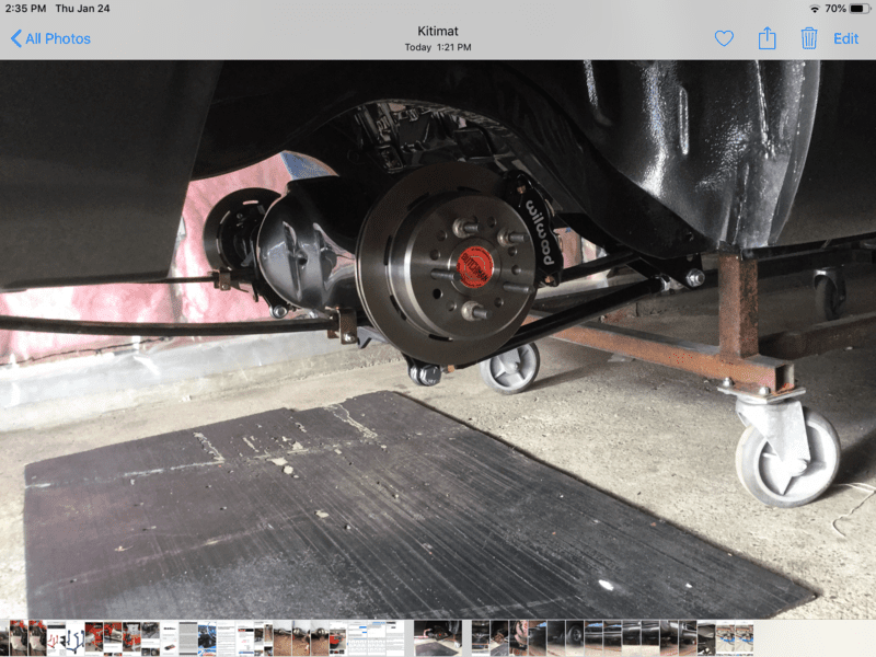

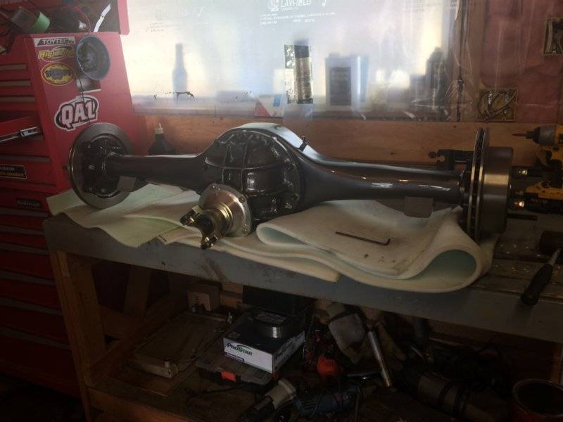

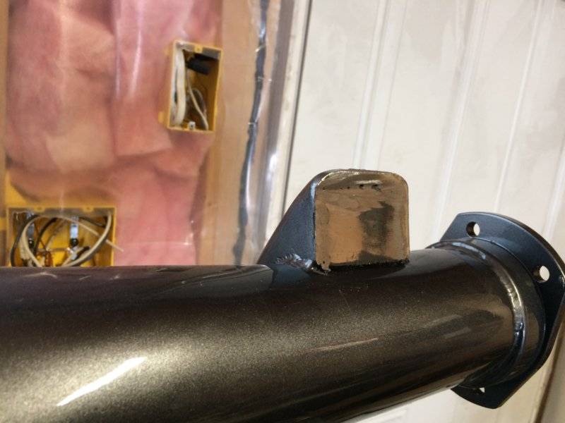

Took your advice and welded my spring perches closed. Not the best job, trying not to mark up differential. Will epoxy primer them next, then paint them in colour sometime down the road.
Finished final body work, and primer on hood scope. Turned out pretty good, should look better in colour.

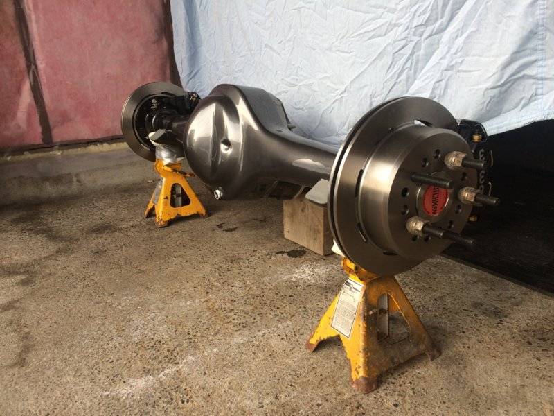

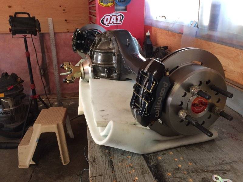

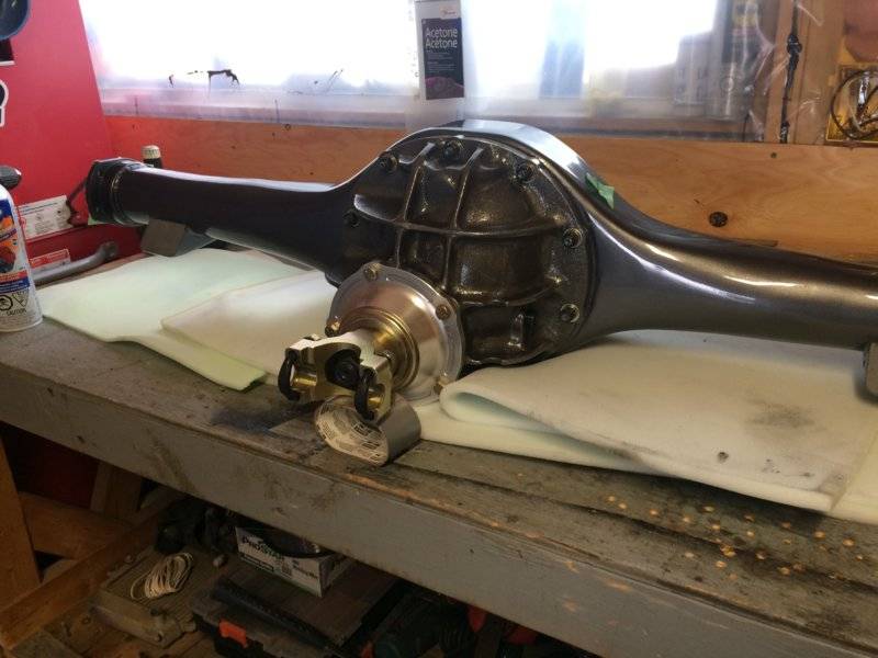

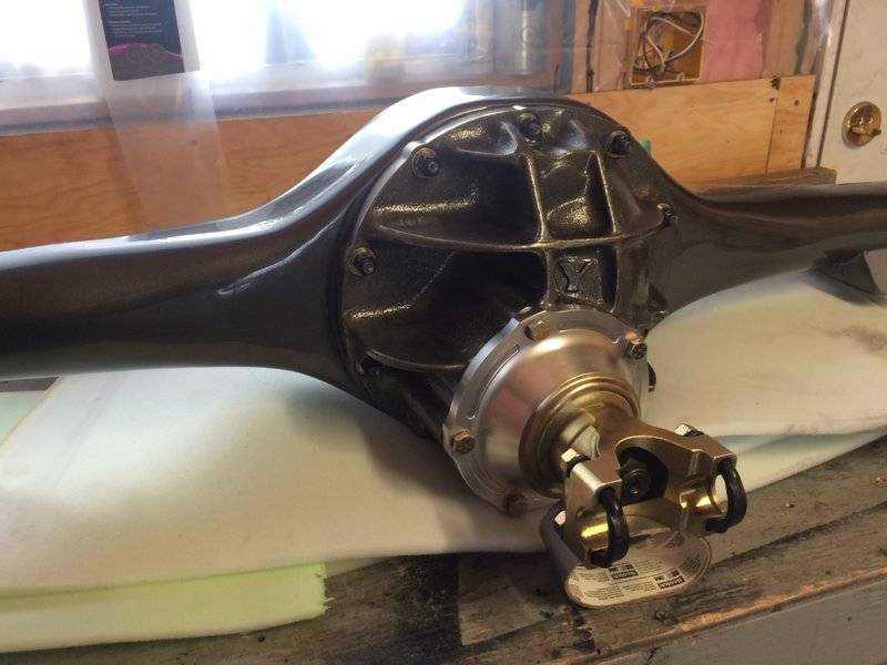

Been working on differential assembly, install third member. Gears are 411, with wave track locker to put the power to the ground.

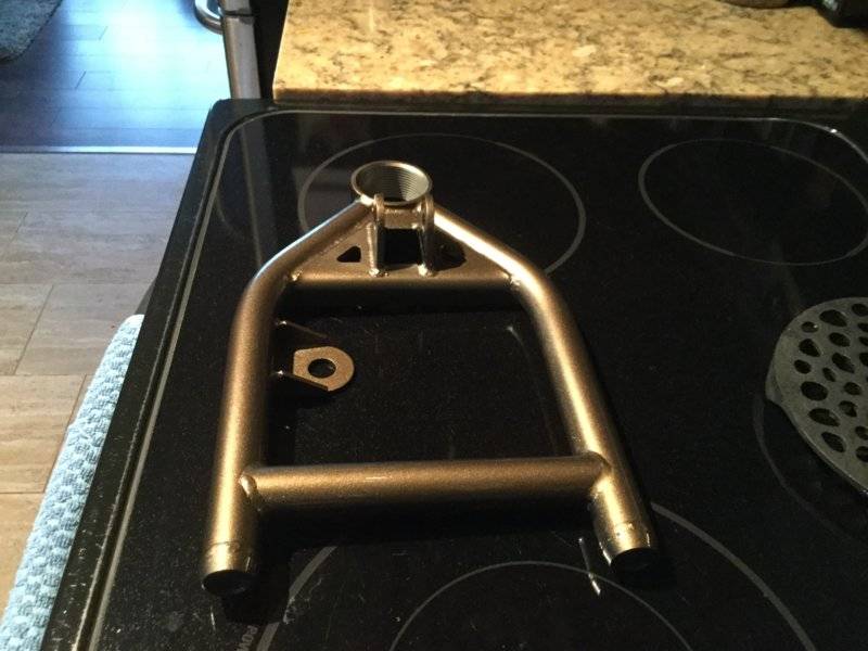

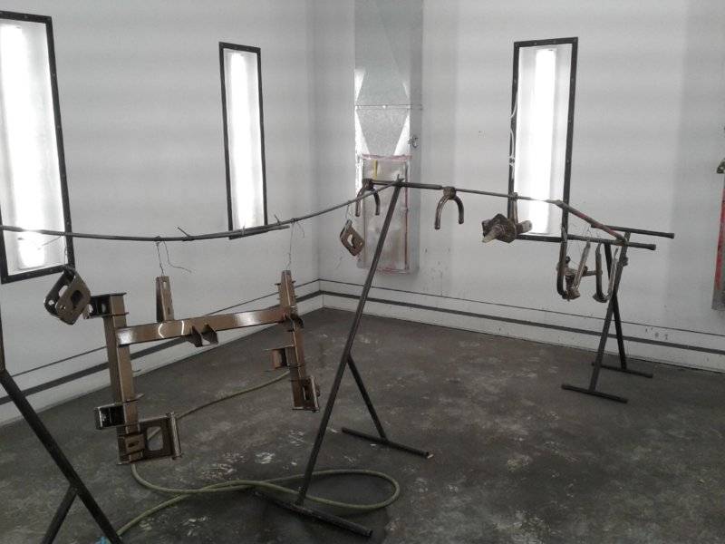

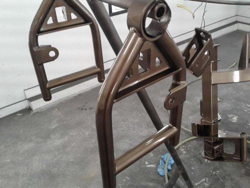

Had some paint layer down on my HDK front end parts. Went with twilight bronze colour, it’s a little browner then I thought it would be. These pictures are from a text, will take better pics tomorrow.

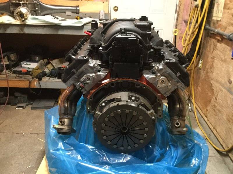

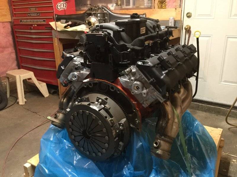

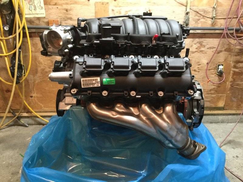

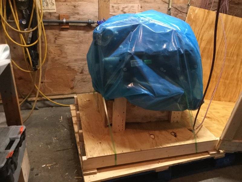

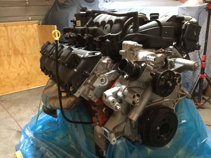

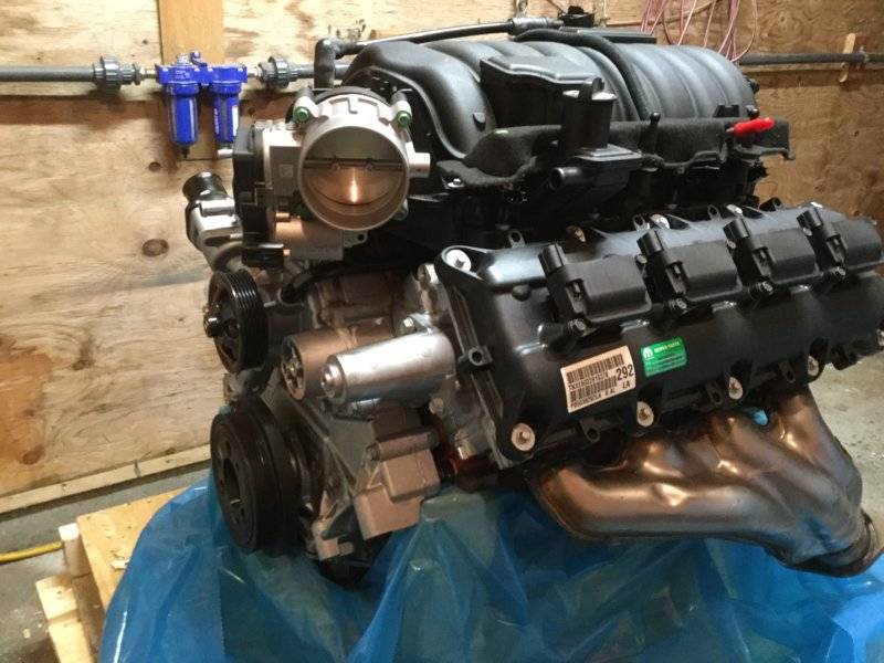

No plans for the dash yet, but pretty sure I will go with aftermarket gauges. Once the engine is in and running, I will then concentrate on that area. Do you have any idea for me, l am always open suggestions. Buy the way, my engine will be here tomorrow. Will post some pictures on the weekend.

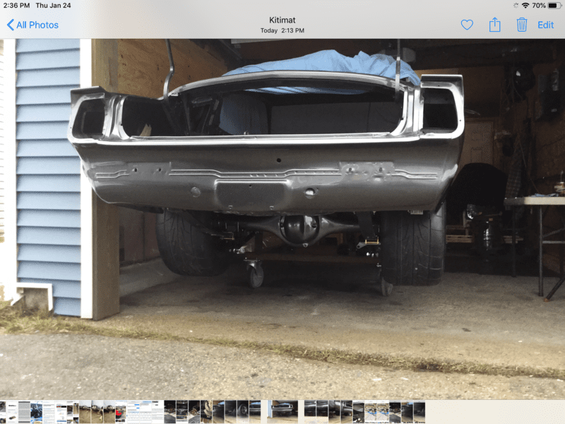

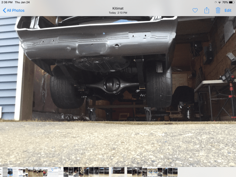

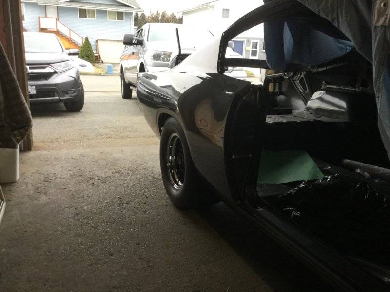

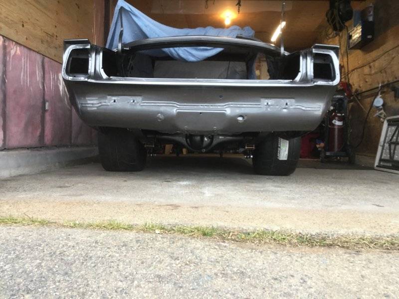

Well sort of got the rear end installed, still need shocks and 3/8 wheel spacer. After spacer I will put the car on the ground, to see how I like the stance.

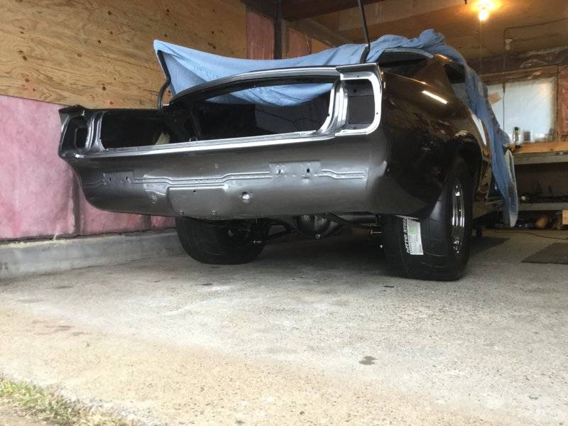

Now back to my car, put the car on the ground today. Like the ride height, but might lower the rear another inch. These pics are with no weight in the car, seats,glass, and other accessories. Also the front end is on dollie wheel and is a little high right now.
...and gasoline is 6.3 pounds per gallon. I'm not going to adjust mine until it is all together and has a full tank.
Never thought of that, good call. The same for me once the car is pretty much complete,I make any needed adjustments.
