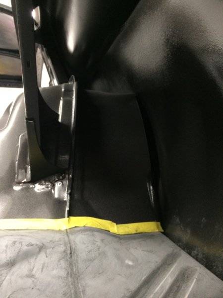

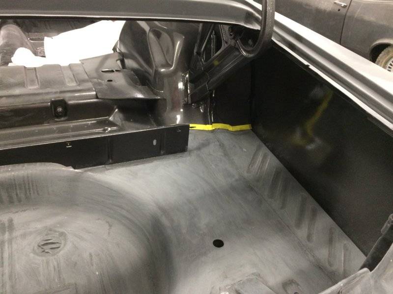

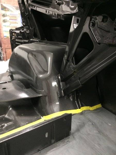

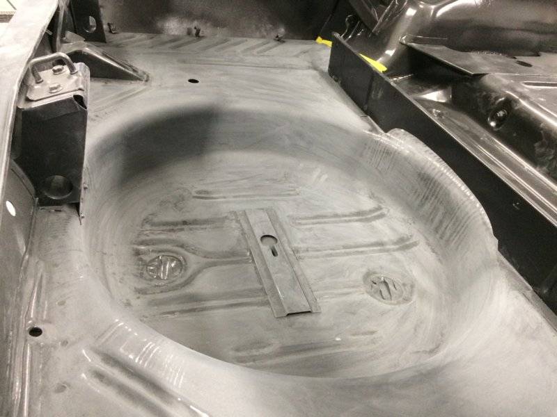

A few pics of barracuda project.

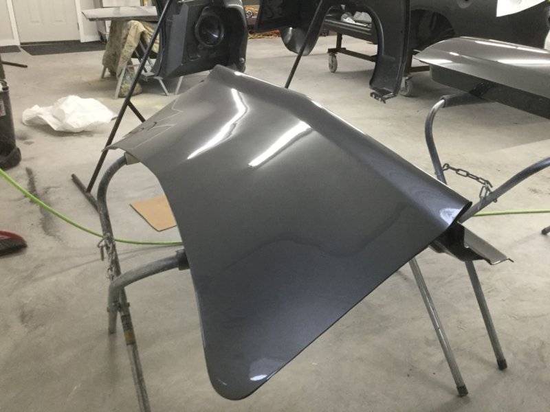

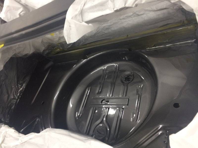

Yes I agree, single stage is not very forgiving. That’s why i will being using base clear for the rest of the project. Even when we reshoot the trunk I will paint base clear this time. Added a few more pics of sanded trunk and how some of the mods turned out in paint. Having problems loading photos will try later.

Why can't you buff the single stage? If your painter used hardner (activator) you should be able to sand and buff out the nibs.

Was under the impression that you can’t buff single stage paint. Hopefully your right, would be nice if’s person can. Maybe others on this site might have some knowledge they could share on this topic.
It is my understanding you can't cut and buff single stage metallic, solid color you are good to go.
Two stage, metallic or solid no problem.

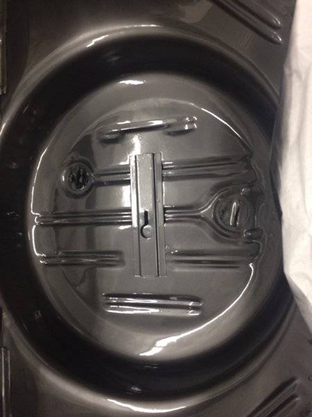

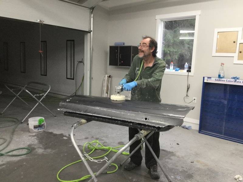

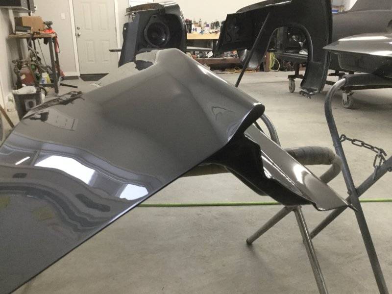

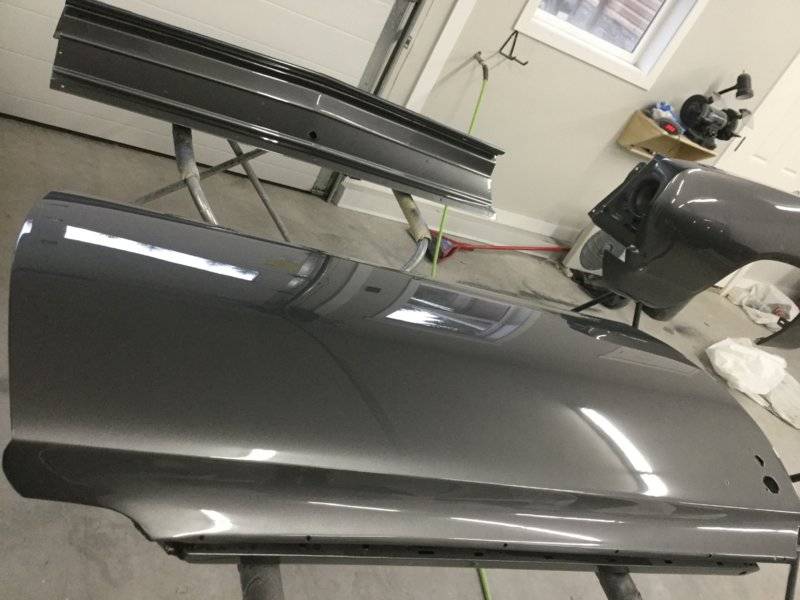

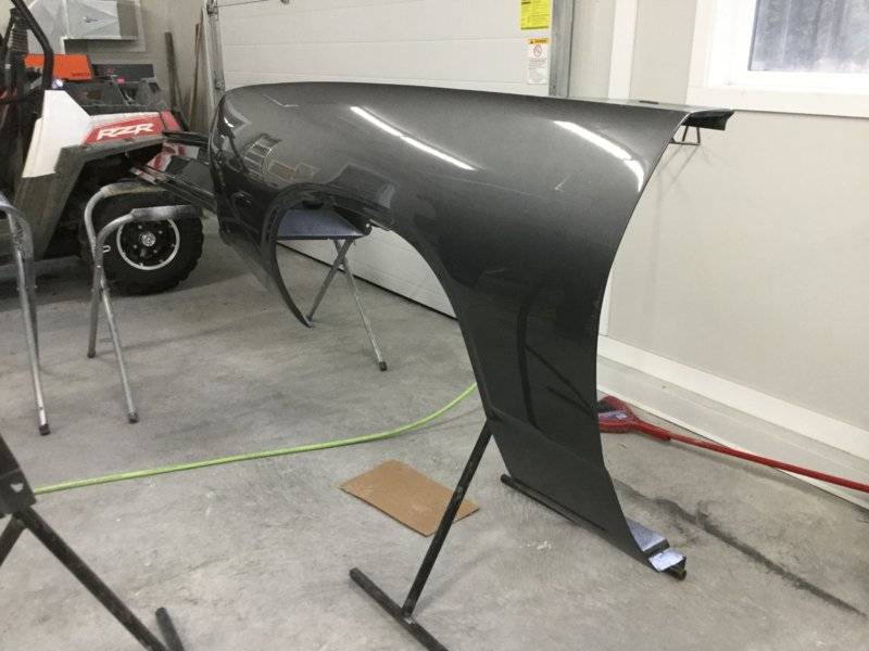

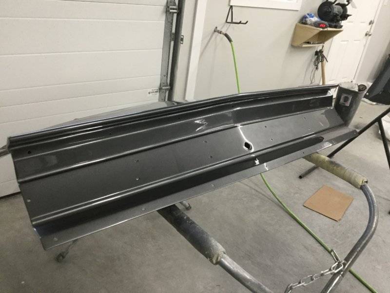

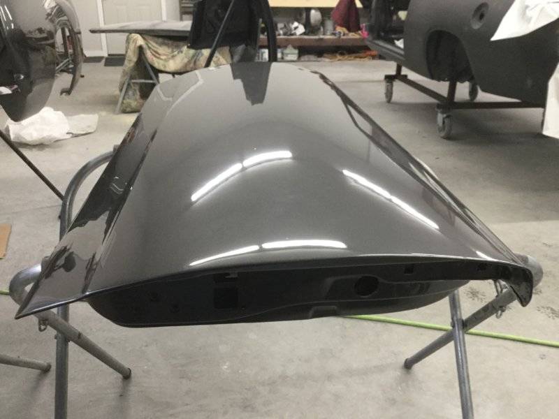

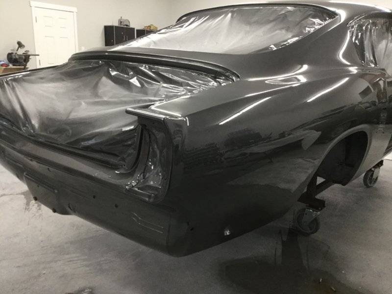

Finished painting and buffing,doors, fenders, and trunk. Turned out very nice, will shoot the car on tuesday. Here a few pics,would be nice too see them outside, but raining like hell right now.

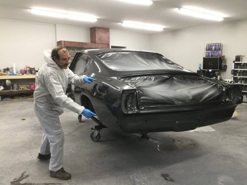

My painter said the clear turned out so good, he hardly has to buff it. Notice the smile on his face.

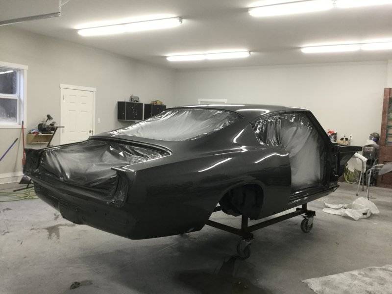

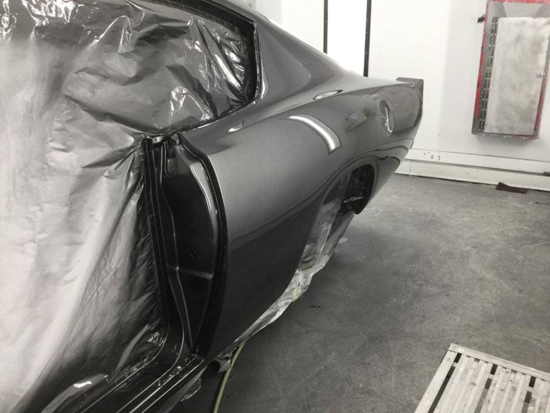

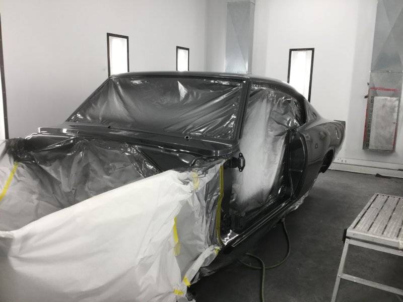

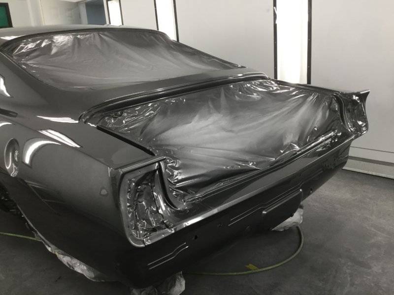

Final paint applied on body of car. Next my painter will buff and polish , then she’s coming home.
The fresh paint looks sooo nice.
Nothing’s like a fresh paint on a fastback fish.

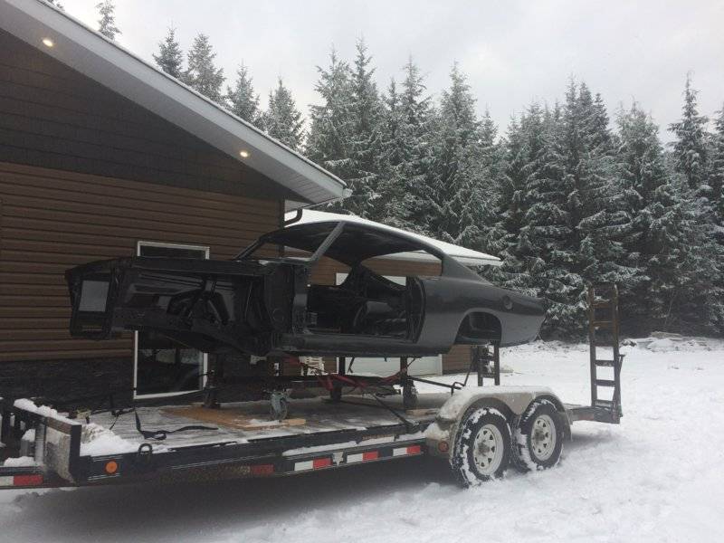

Things have been going very slow since I got it home, hope to get things rolling in the new year. Had a two of my brother sick and hospitalized which became priority over my hobbie. Then came the Christmas holidays, figured I would just start fresh in the new year. On a positive note my, new 6.4 has arrived too the dealership that I ordered it from. Had about a eight week wait for that, but still haven’t received the engine computer and harness. There is now a new part order number for it, I guess there have been some changes made to them. Will post updates as they come. Picture of car on it way home from paint shop, and our first snow fall. My luck.lol

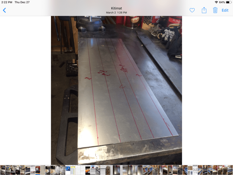

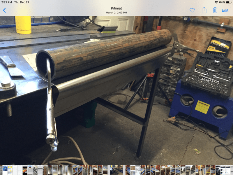

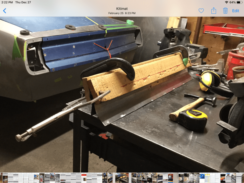

Had to bend up three pieces, trying to get the same radius. Don’t have a metal brake, just use what you have I guess. Then pick the best two.
Your manual metal forming skills are awesome. I’d be grateful if you would share the guage metal you used and some of the techniques of how you achieved the shape of the chin and rear spoiler with “the tools you have”. Thanks that is awesome work.
Used 18 gauge mild steel, probably could have used 20. 20 is a much easier too wrk with. Too get the radius for the the chin spoiler I just marked the center of metal I was using, then bent it over a peace of electrical conduit. After the metal mostly shaped, i clamped it with plywood on each side and finished the bend with c clamps. There is a easier way if you have access to a metal brake. If you just loosen off the brake edge the same on both sides, you get a nice consistent round bend instead of being sharp. One side of my chin spoiler was bent by hand and the other was on a brake. It took two try’s too match the hand built one. Sure would be nice to own a metal brake, life would be a lot easier. My rear spoiler was totally made by hand, plywood and clamps. Also used a little heat when bending. When I bent the rear spoiler back towards the car a clamp a 4 in pipe to my work bench over the metal. This gave me a nice gentle bend that was desired.
