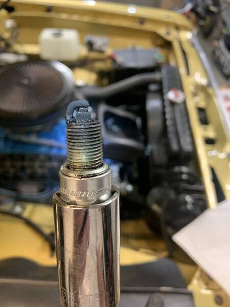

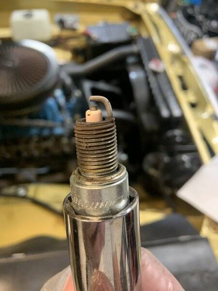

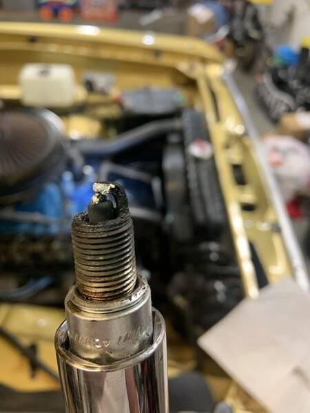

Cylinder is packed full of crap. Not sure. They were all gapped the same. All rocker arms moving correctly.
Oil fouled, bad rings or cracked valve guide. imo
White smoke is an indication of burning water, blown head gasket or cracked head ?
Gonna do leak down and compression test soon and find out. Hoping just valve seal letting oil dump in there. Guess we will find out.
White smoke both sides: could be faulty brake booster/master cyl drawing in brake fluid.
White smoke one side: most likely coolant drawn into the cyl, the cyl that has light coloured crap on the spark plug.
there would be an indication of brake fluid on the plugs.
water and anti-freeze tends to keep them clean if they fire.

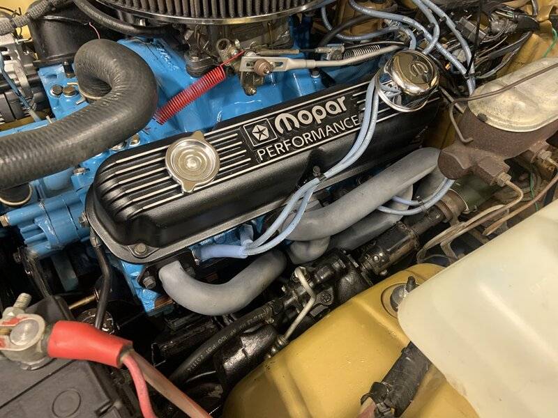

Well here’s what I ended up doing: I bought some 302 heads that already had 1.88/1.60s in them. I spent about 18 hours porting them after watching videos, especially @MOPAROFFICIAL videos on porting 302s (thanks btw). I did not do quite as much as he did on the videos but I did as much as I was comfortable with. I had a 3 angle valve job and heads resurfaced. I lightly ported my performer intake just to get the ports opened where they neck down for the small port heads. I had issues with intake lining up. I believe the prior owner may have slightly milled the heads, but I’m not pulling them off to find out more. I found some Hedmans that were new in the box since the 90s.
Fired it up last night. Took about 30 seconds tuning the carb and took it out. I did not retime it. HUGE difference. Last year my buddy’s 454 Chevelle would pull on me but last night I hung with him fine. Was really surprised. Car needs a little more timing and probably a little bigger carb. Very happy with the results other than the VHT not holding up lol. Appreciate everyone’s input along the way. I wouldn’t necessarily say I’m a 302 head fan now, but I’m a fan of the right combo with the right port work, and I believe on my little 318 with what all has been done, it’s a nice little combo. I’m sure there’s more in it with a performer rpm or air gap and a 650 Holley, but for now I will enjoy the setup and seeing what I can do. Thanks for the input guys.
