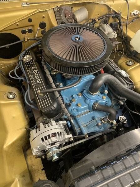

Looking like I gotta pull my heads for valve seals this winter so I’m considering putting a little more into it while it’s apart but still staying in budget. Currently it has Basically stock 72 318 heads. Engine is bored .030 with KB pistons, .470 lift Comp cam, edelbrock performer intake and 600 eddy carb. Stock 72 manifolds.
Looking at doing 302 heads (may put 1.88s in it and porting them), Holley 650, maybe some higher flow manifolds (maybe porting them, but that doesn’t seem to be a common thing?), and porting my performer intake.
It’s got an 8.25 with 3.91 sure grip and a 904 with 2800 stall. Just making sure I’m heading the right direction and not doing anything stupid. Hasn’t seen the track in over a decade, gets into a stoplight battle from time to time, and I like reliability as I regularly drive it around town. Open to suggestions but from what I’m reading I think these are good small updates from current setup.

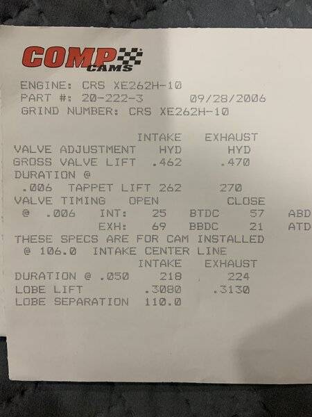

Headers or magnum right side and 340 exhaust manifold. Is that the solid or hydraulic .470 lift comp grind? I personally don’t look at the 302 heads as an much of an upgrade, as noted by @MOPAROFFICIAL. I would wait for the speedmaster Black Friday sale and see if they have one this year. But if hanging with iron, your combination looks like it could make use of some 360 heads milled enough to at least maintain what compression you have with the right gaskets. What kind of ignition do you have on it?
Hydraulic cam. Here’s my cam card. I’m not closed minded to a J head or X head, just with milling I’d hate to then deal with gasket issues on my intake. And I’ve seen more positive discussions with 302 heads or even 67-69 273/318 heads. Eh aluminum heads will be more than I’m wanting to spend at this point.

[2] Cam is a good compromise for drivability, power, longevity.
[3] I would mill the heads for 9.5:1 CR, even if it means milling the intake faces for intake alignment. Compression makes more power EVERYWHERE, whereas other mods may only make more power in some part of the rpm range.

It may not be budget friendly, but after seeing MOPAROFFICIAL’s response with the speedmaster/ProMaxx magnum heads and having first hand experience with magnum power, that’s my favorite option here. Maybe see if they’re available for sale on Black Friday. Get their air gap intake while your at it. Upgrade springs and retainers for extra lift, and I would probably upgrade to this cam being you’ve already got 3.91 gears and 2800 stall. The 1.6 rocker ratio makes .507/.532 lift.
