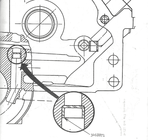

I got a question, and an ask. So I finally got my block back from the machine shop. Guy had it awhile, he did a good job on everything, was super reasonable doing this as a friend of mine. I am aware what this work costs, I was charged half the going rate. I gave him my brass core plug kit to install water jacket core plugs, and told him not to install the oil gallery plugs so I can do one more final cleaning. So I checked and have all the threaded in plugs, and only one 19/32" push in plug. It's been well over a year since I dropped the block off.
Am I correct in the fact that theres 2 of these pressed in at the front for the lifter oiling bores?
I am also missing the 2 in the back of the block. Those are 1&5/8" he claimed they were different size. I will go back there monday and ask if he has 2 of em in that size.
The 3rd question involves the press in plug that goes in the back of the block under the main cap, and separates the oil gallery passages by the oil filter. What size is that one? Is it also a 19/32" plug? If it's not, does anybody have one they can spare?
Thanks
Matt
I forget the plug size of the oil passage separator rod the oil pump. I’m sure it’s in a book somewhere.

Hi Steve, I'm not sure of its dimensions since its waaaay up inside the block. From my quick and dirty research it appears it's a 9/16" plug. With a flashlight I can see the shoulder. But cannot get a caliper on it. The blueprint drawing has a PN. Probably $30 from the dealer lol. it looks like that one plug doesnt come in the kits. Can you check its dimension?

The kits dont seem to come with this one plug. It's apparently 9/16". I have heard people say they dont remove it when rebuilding the engine. Why not? When you gun brush it out, you dont want any crud left behind. My dads 360 I knocked this plug out, and his core plug kit came with a new one. That was 23 years ago though.

I’ve said this so many times it’s now gone full on retard.
You do NOT need the gallery plugs behind the cam plate. I’m old enough to have taken apart so many small blocks I cant count them and NOT ONE had those stupid plugs in them. Not one.
Just like the stupid bolt with the hole in it and the drip tray, it’s just more shot that guys mentally masturbate over for no reason.
Make sure the plug is in the gallery that is under the main cap and move on.
You are wasting time putting plugs in those holes.

My point was you spent an incredible amount of time on those two core plugs that you don’t even need.
I’ll say it again, you don’t need the plugs in there and you don’t need the bolt with the hole in it or the drip tray or the oil slinger. None of that.
Since you are bounds and determined to use the plug, put a .040 hole in it and a .040 hole in the cam retaining plate where it covers the oil gallery.
That will get you pressurized oil to the timing set. That’s what I’d do, except I’d leave the plug out and just drill hole in the plate and send it.
At minute 41, the cam plate is removed. I don't see plugs in the two oil galley passage holes. Some people put plugs in these holes behind the cam plate. Did the factory use plugs there? If not, is there any reason to plug those two holes? Thank you.
And honestly I cleaned it all up, oiled everything, and wrapped it in a fresh new trash bag. Its sitting in the corner of the shop now. I do not have the time or the mental capacity to deal with this uninterrupted right now. This may also be the reason my 07 mustang GT has been sitting unstarted, unused under a cover sitting on 4 flat spotted tires for the last 5 years in my garage. I walk past it daily and ignore it. I honestly just dont want to deal with it. The amount of B.S. I have to put up with in my life lately has been too much. I honestly dont know how I keep going. The latest was the 2015 Impala LT I bought my wife with only 17k on the clock. My 16 year old with mental health issues steals it and wrecks it. I have not even made a payment on it yet, plus my 10 year old with Aspergers and ADHD is at a 7 year old level mentally, and will now have to be homeschooled. Ya, I got enough on my plate. Life isnt really grand for me right now.
You really don't need them. The retainer plate blocks them off. No sealer so there may be a little seepage there because of no gasket or seal. If your pumo and bearings are in good shape it might not be an issue.
