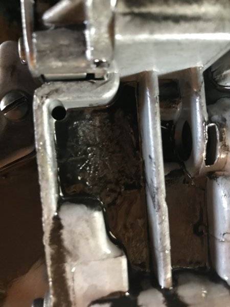

BTW - when I swapped the VB there was quite a bit of band material in the bottom of the pan, no metal but a lump of band material. (Hopefully not clutches...)
I know some is kind of normal for new band/clutches, this seemed like more than I was expecting to see.

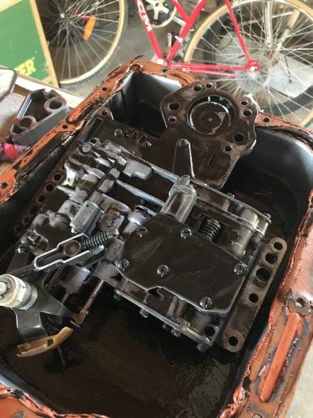

So just an update, I removed the valve body and checked the band adjustments and the servos. Again, front band is close and probably a little tight.
No material in pan this time when removed.
Re-installed VB (1970) and used 42RE deep pan with added drain plug along with reusable Mopar gasket.
