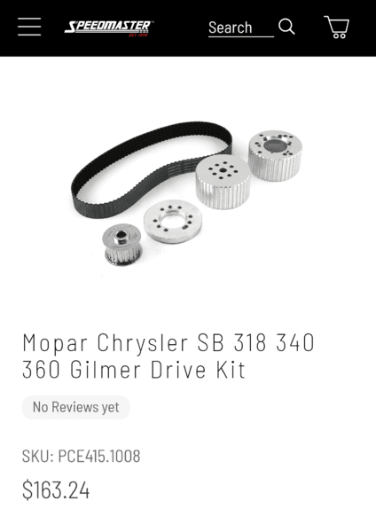

I was wondering about putting an aftermarket pulley setup on my small block. I just run the water pump and alternator. I was hoping that having a geared one would stop any slipping.
I was wondering which sets people were using and what problems they were having or had installing? Also I'm curious on changing the alternator pulley? Maybe slipping is a good thing sometimes so things don't get broke? Anyways thank you for your time and experience..
Example:

I noticed that CVF now has an 8 rib pulley system, which I think looks neat. Maybe I'll try that out one day. However, I do like the look of that cogged belt system you posted. Another possibility.

That is one nice set up. I could never get mine to stop slipping and coming off I tried everything. even a deep groove over size pulley on the alt.. I got sick of buying belts. By the time I noticed it was gone It was to late. I could not tell You how many different brands I tried. The total length was 17.5 inches . it would never make it to second gear. I eventually put a alternator shut off relay on it. I believe the alternator was to hard on it.

I too have the march to groove underdrive pulley as well. I used it when I had the electric water pump and all I ran was the alternator. My stock one was too fast and like I said I wouldn't make it past 2nd gear and the thing would fly off! Align my pulleys up with a 3ft metal straight edge. They're spot-on and my belts are tight and new. Anyways I thought that hundred $70 setup looked kind of slick and light and direct. Once everything gets to be just so you start looking for stuff to spend your money on LOL...
There was no reviews on it I was just wondering if anybody had ever tried it....
