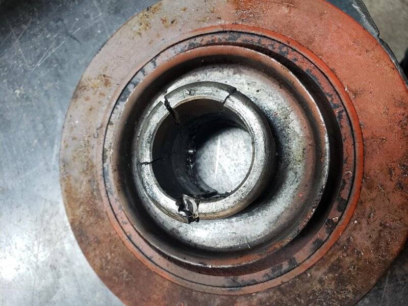

p.s. Here is some pics of the "before".
What in the world caused the catastrophic failure of the initial build?
I think it was poorly chosen parts along with a comedy of errors. I doubt the rod bearings binding up on the crank fillet helped much and probably added to the issue of hard cranking. J.Rob

That’s what a junk **** damper will do.
There was a rash of those cast stroker cranks that were breaking a while back. They were all the same brand......it was either Eagle or Scat I don't remember which. But we saw a lot of them break right here on the forum.
Eagle cast cranks
But many seemed to have a little “help”.
Eagle cast cranks
Oh I'm sure. It's not like those cranks were made for extreme use, yet I'm sure that's what they get. "Cast steel" is still cast. lol
it's that the Metallurgy was ****.
You can put 550 -580 through a GOOD cast/nodular crank and it'll hold up.
After that...its like tap dancing in glass shoes.
Scat is quality and so are ohio crankshaft & mopar cast cranks, all known to take abuse.

Several years ago a bunch of Eagle 4" cast cranks broke, IIRC most broke right behind the #1 main cap or in front of the #5 main cap. Several of them were in mild builds that weren't beat on hard.
I gave my guesstimate on power output in the first post, if I'm even close--I would put it in the category of "not beat on that hard" . J.Rob
