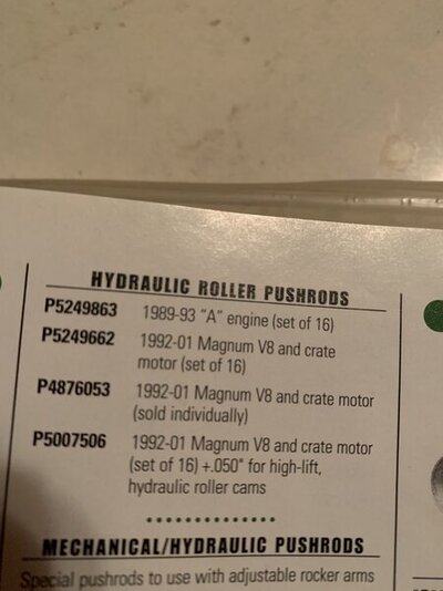

Magnum crate engine pushrods service part numbers below.
P5249662, (16)
P4876053 (1)
Or this, P5007477, Magnum head on LA block (I Think there saying with a Hyd cam) with Magnum rockers.
Or perhaps?
Now that I gave you all of that info, which COULD leed you down the wrong path…. Learn how to use and get the following stuff to measure it yourself and properly!
This is what you need to get for yourself or borrow.
Powerhouse POW151215 (12 inch caliper)
Comp cams 7900 (Ball and ball for Hyd cams, LA stamped rockers
Compcams 7709 (-1 shown)
Ball and cup, Hyd or solid lifter and an adjustable rocker.
P5249662 is the part number for 16 replacement pushrods for your engine. IF I knew the head gasket thickness used and the base circle size or had a Hyd roller cam to stab into a 5.9 I have laying around that happens to be cam less, I could tell you.
