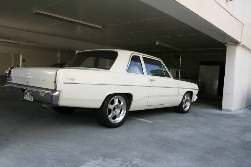

At this point I have nothing to add beyond ANOTHER white Valiant 100 sedan with a DS fender that doesn't match...
I'm looking at potentially going to 18's as well, to avoid converting the OTRE's to Heim joints - if there's enough clearance. Found out the hard way that not all wheels are made the same, but with the right wheels, a 18x9 should fit easy on all 4 corners, along with a 275-series tire.
Carry on, I'm subscribed now...
Clair
now THATS freaky !!
what are the odds, complete with primered lf fender and wrong colored hood!!
damn fine car you have there c. davis lol
Tell me about it! When I saw the first photo of your car in this thread, I thought - hey, that's my car... wait a minute, I don't have those wheels on my car! Nice ride you've got there, BTW. I'm kind of surprised those "R" wheels fit as well as they do, I really like them but always passed because I thought they'd rub.
