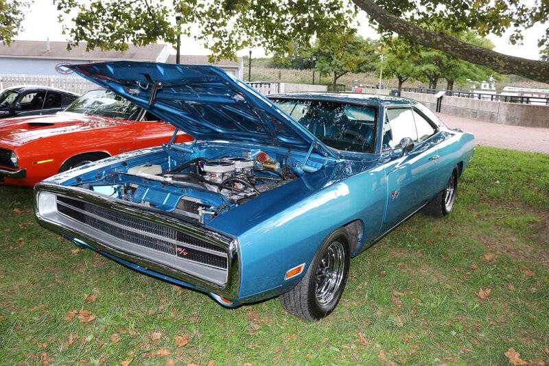

good friend's Charger with a 400 stroked to 498''
