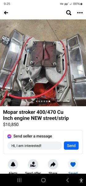

Not mine bit I found someone selling a fresh build with dyno video on facebook market place. It made 600 Hp at 6,000 rpm on 91 pump gas. They are wanting 10,000 for it. Is that a good deal or not?
That is definitely a good deal considering about $ 2800.00 of mine is just the intake and carbs that's not even counting what it would have cost to weld , port the tunnel ram & resurface all machined areas
It is a fair price if it was put together correctly with decent parts. Before buying it you should ask for a parts list and look over the receipts.
