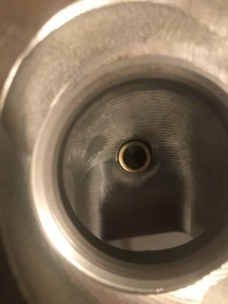

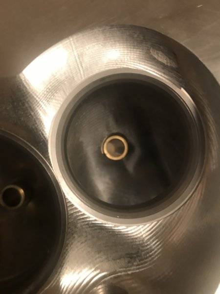

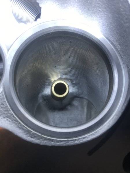

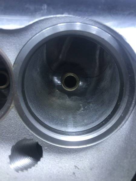

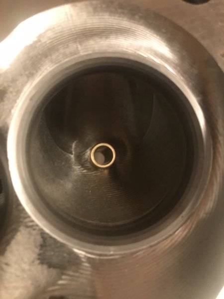

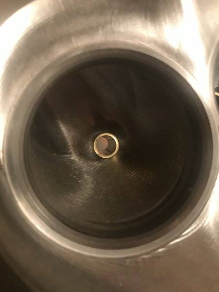

Here is a few pics of the Sb heads. The guide clearance is just right also. Kim
That valve job went out in 1995. They may look nice and they may be round, but I haven't done a VJ like that in over 20 years.
That would be the first thing I'd fix.
Don't grind them with a rock?
Machine them instead?
Well, then YR. enlighten us what we need done so we don’t go down the wrong path. We want it done right. This way we will know if the machinest we talk to is the right guy for the job. Thanks. Kim

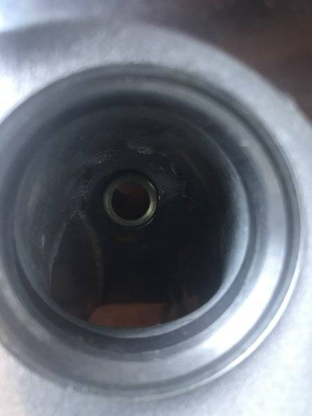

Received my SB CNCed heads yesterday, they look okay but the seats will have to get a more modern valve job.. Was a bit alarmed when the 1st thing I pull outta the box is talking about Bowtie heads.. Huh? Also not thrilled that the part # I ordered PCE281.1656 is nowhere to be found on the head. I don't have enough SB Mopar experience to know if these are even Mopar Heads and don't have my block yet to fit them to but I'll try and search for something that shows SB Mopar head/ bolt hole spacing dimensions...Probably in my old DC Performance book.
Will they flow? No clue but it is my 1st set of Aluminum Heads and hope it was a good purchase.

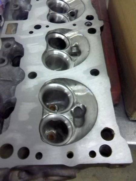

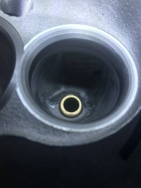

Anyone else notice that the SB heads that @Hemioutlaw has, now include chamber work? All the other heads I've seen posted in the past have had as cast chambers.

Yes, I did notice. Kim
You have a set of bare CNC'd that don't have chamber work, would you be willing to post a straight on picture of a chamber, higher res the better?
Did notice that myself as what I had read about the heads in this forum prior to purchase eluded to no chamber work
