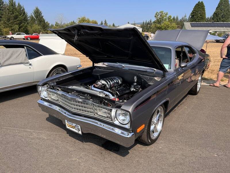

I purchased a kit for my 73 Duster and have questions about getting a shift linkage from the 4L60E to the floor in the stock shifter location. How did you do it? What kind of custom linkage did you make or find to make it work?
My car has been modified and has a gen III 6.4 hemi and I had a tremac tkx 5 speed in it. Any help would be appreciated.

Whoa!! Nice car!! :thumbsup:

Sweet car! And you are (kind of) local. Cool.
