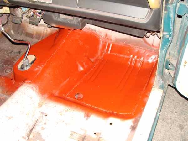

I did a 4 speed swap on my Duster about 2 years ago. It was the first A body swap that I had done. I went from a 904 to an A833 from a 69 Swinger. The driveshaft not only had the right yoke it was the right length. I had bought most of the swap stuff at Spring Fling in Van Nuys Ca years ago. I had to buy some parts new from Brewers, which BTW they were unbelievably helpful and I didn't hesitate to buy from them when I needed something. I bought the shifter, boot, clutch fork, and handle from them. I forget how much I had in it but cost got kinda out of control. Here are some pics.
http://www.forabodiesonly.com/mopar/showthread.php?t=81690
I suppose I should have started a thread about the restoration of the car. But this thread has some good pics.
