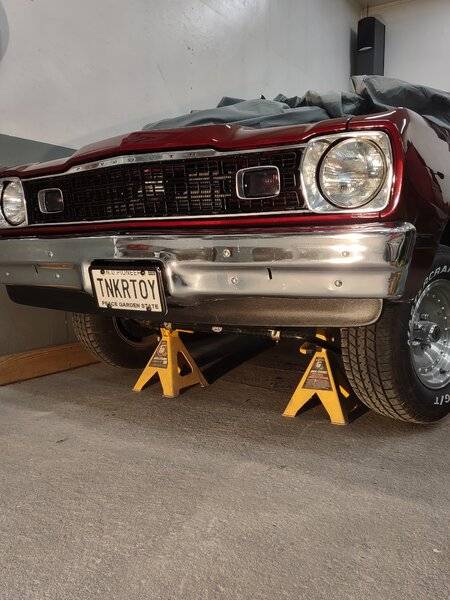

I tossed it on real quick to get an idea of what it would look like. Garage is too small for a decent picture, but I think I like it. Needs a little minor trimming in the middle to fit nice and tight, might be able to get to it this weekend.
