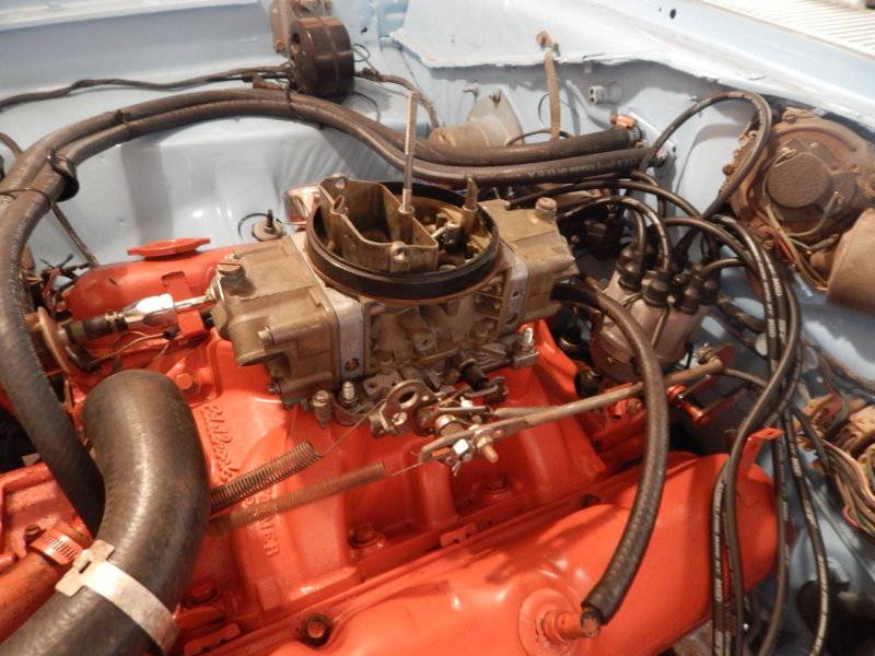

Using a DP on the street is a step backward from an AVS and a giant step back from a TQ
different learning curves on all three- run what you know best or figure the time to learn
The specific carb is a step backwards. I'm a firm believer that EFI has it's place, but it's not on old cars. That's just me because I consider the smells, the tuning and retuning, and the maintenance as all plusses to owning an old car.
But in this case - a DP of any size will require some very specific tuning to get as responsive and "right" as a vacuum secondary on this application. This is a mild engine. The extra squirter and power valve is overkill for what he has, and the low stall and low rpm use that it predominantly gets will be negatively affected too. So it's a lose-lose. I'll go out on a limb and say it will "feel faster", but the track times will show otherwise.
Appreciate everyone's thoughts. The only reason I'm giving the DP a whirl is from past experience. I've never had a vacuum secondary out perform a DP at the track on mild street cars. None so mild as this, though. I expect the DP to be a slight improvement, even on this "virtually" stone-stock 360 and 2.45's. Of course, the car will not always like what I try and rebel against some of my ideas …. LOL
If weather permits, we might find out next Saturday :)

It's on.... I did a little testing out of town.... :) … I firmly believe the E.T. has just been shaved !
From experience, if the DP is faster in a milder combo, the VS was not totally set up. Just my experience of course...
Keep in mind, the same person tuned both VS and DP carbs (and the 600 eddy), me. Also, if the VS proves to be faster I'll bolt it back on in 2 minutes. It makes no difference to me other than I want to keep tuning the car faster.
