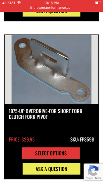

Pivot for short fork in overdrive bellhousing
You would have to drill the holes in the correct location. Probably better in the long run to do this and use a short fork versus having to make a bellcrank to work with the long fork.
