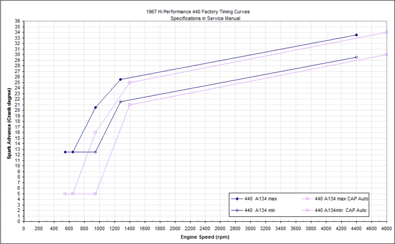

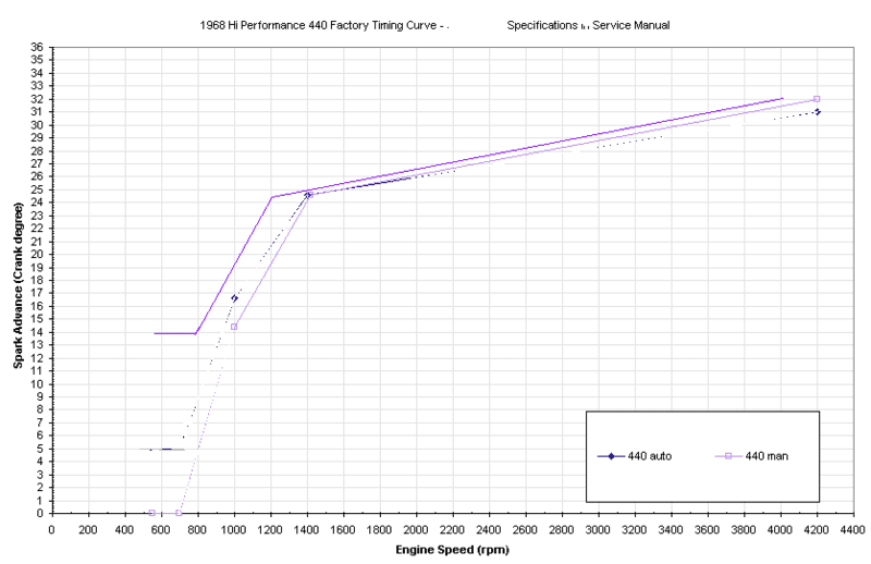

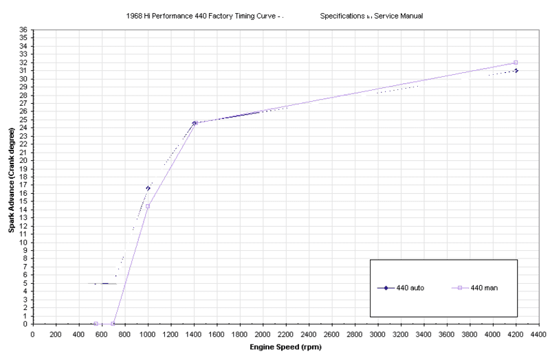

Since your working with a 440, its worth looking at factory 440 hi performance timing.
This is the range that was acceptable for Plymouth when inital was set at 12.5 BTC (or 5* BTC for a smog distributor).
Many of the electronic distributors have a timing curve that is something like that that '67 CAP timing advance.
These CAP and CAS advances used a fast and long primary advance to get the off-idle timing back where it should be for efficiency. (The late timing at idle was neccessary for more complete burning of HC and reduction of CO.)
The above timing curves work well with vacuum advance. Thst long slow secondary advance also works well with electronic ignitions as it helps offset the slew rate that Yellow Rose posted about.
So when we take early emissions era Chrysler distributors and shorten the inside slots, we get somethng like this.
Now with good fuel and at reasonable elevations, we can often advance that initial somewhat. If doing so increases the mph at the track, then thats what it wants.

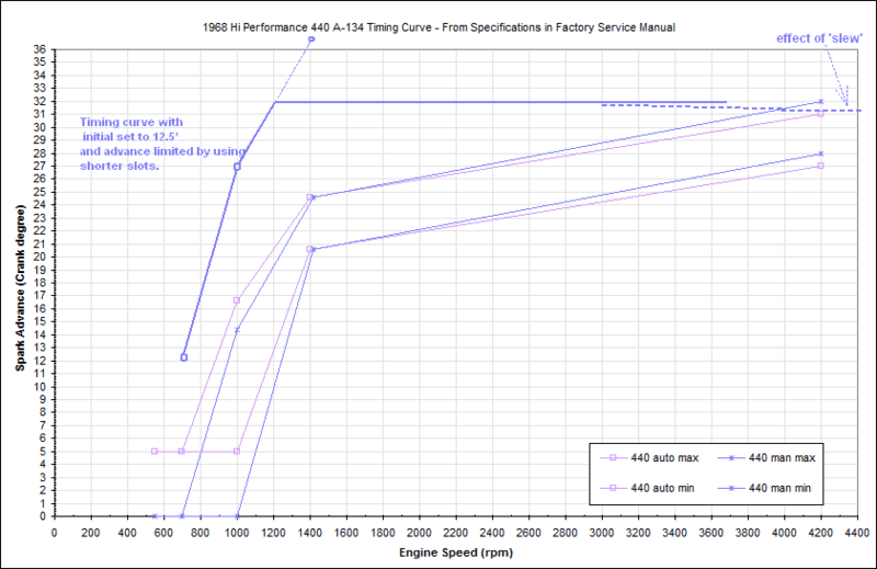

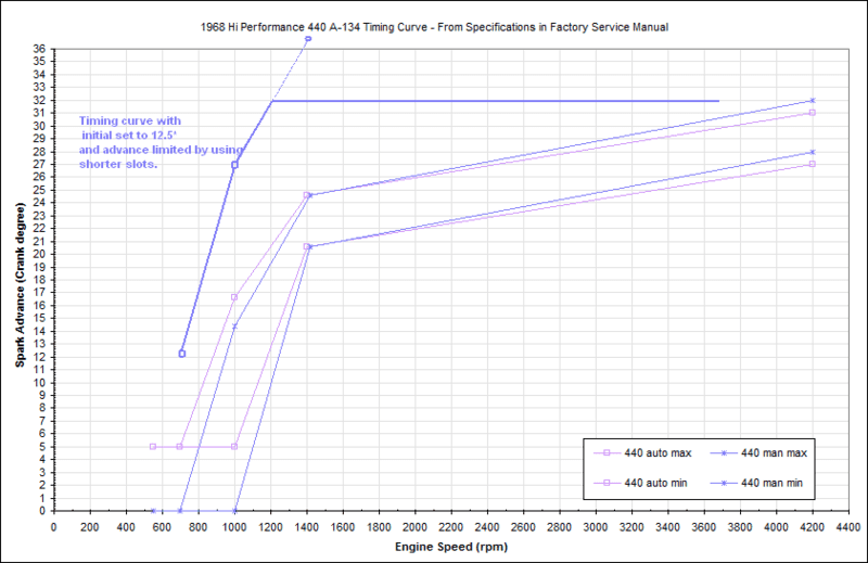

In contrast, here's an example of limiting the top end of the advance for a '68 440 manual smogged distributor.
This might have worked good at the drag strip with dual points and no vacuum advance.
Its completely unusable with vacuum advance and if used with an electronic ignition will retard timing at the top end.

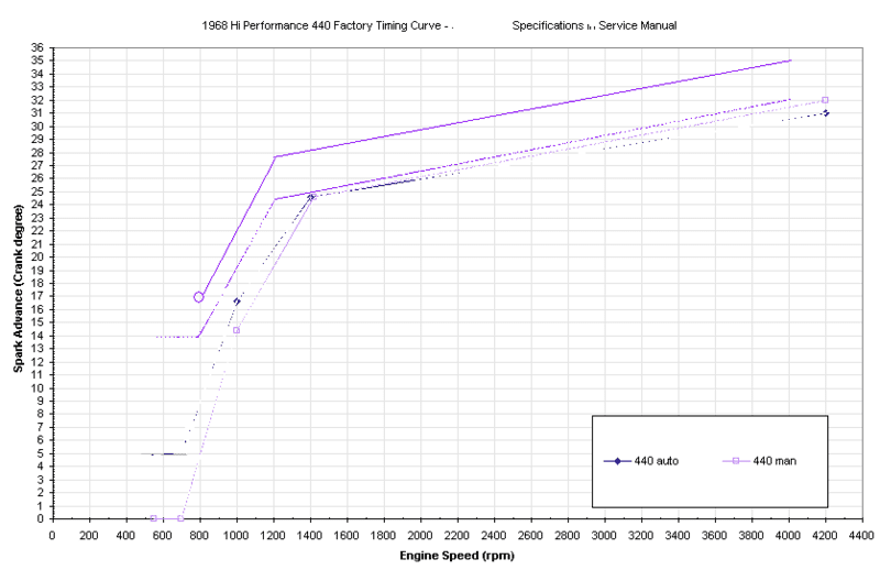

Welding up the inside of the advance would make the advance start a little later if everying was stock.
For example lets say the distributor in hand mapped out to have a timing like this
Its a handy one for the example because the factory initial was TDC.
We see by the timing light it has 32* advance. Lets pretend this was a electronic distributor. In which case the advance plate would have something more than 16* in the slots.
Lets say we weld up the inside of the slots enough to get 18 degrees of advance.
If the engine still can idle at 700 rpm, then yes the advance will be delayed.
If you can get your engine to idle that low, great!
If you can get it to idle at 750 or 800, that will be good too.
If its a little higher, don't sweat it.
Regardless, if the advance isn't starting until several hundred rpms above idle, the spring to adjust is the light spring.
(I call it the primary spring because it controls the initial portion of the advance.)
Before going through the trouble of finding a different spring, experiment with reducing the initial tension as shown in this post
That will bring the advance in sooner.
Advancing the initial to 17* at 800 rpm, the curve shifts up.
No. The heavy spring has a long loop in it. This spring has no effect on the first part of the advance. Its the secret sauce of the two stage advance. ;)
