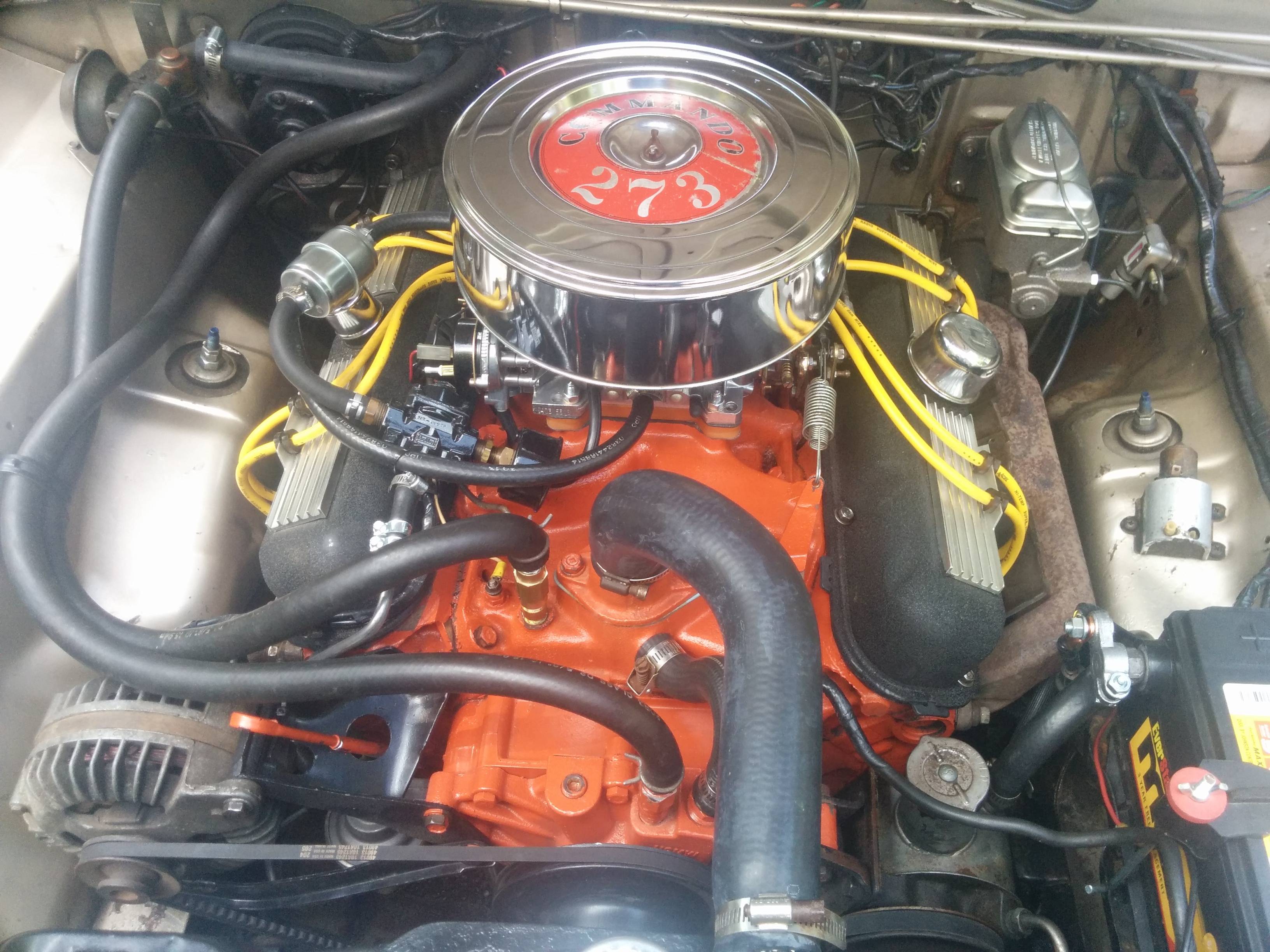

Where did you get your plug wire valve cover holders from? Engine looks great Dustin
Yep like bbrroowwnn said, the factory used this type of valve cover on the 273 Commando engines. Not sure how hard they are to come by. I redid my covers by removing the old paint and using "wrinkle paint", then baking them in my wife's oven (she wasn't home at the time!). It's been about two years and they still look pretty good.
Thanks!! I was in a hurry to get the motor in so I used Hemi Orange paint. Next time I pull it I'm going to go with something closer to the factory block color...I've heard Chrysler is close. The engine bay is the original paint...complete with a run on the firewall.
The valve covers turned out great. I was curious of the plastic clips the hold the plug wires to the covers. I've found some before but they were for skinny wires. Thanks Dustin
I used the original clips. My won't "clip" together, but they will, with some pressure, push into the metal wire holders. I use the Pertronix igniter and a Pertronix 40,000 volt coil so I wanted the 8mm wires. Along with a mini starter the engine fires up in no time!

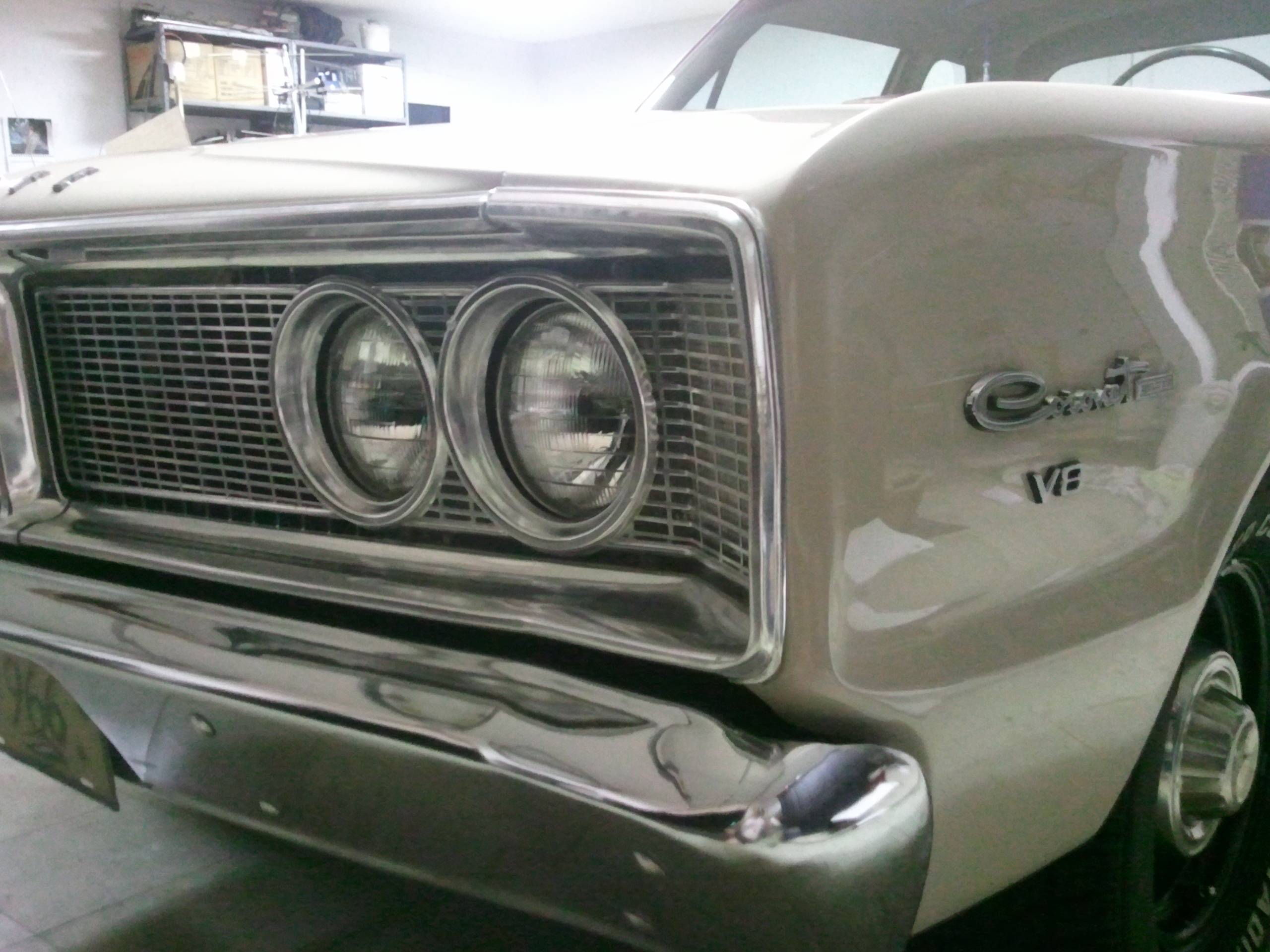

She is a little dirty right now!
Not too dirty!! Looks good.
