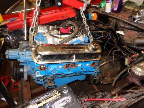

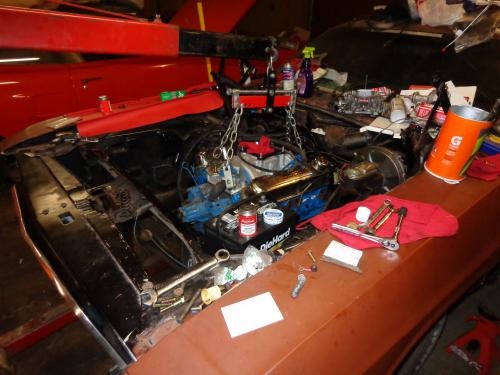

Use a carburetor plate.
Like this....

Thanks for the suggestions. I like the carb plate idea. Will the stress of the engine weight not do damage to the carb mount holes? Also, will it be too difficult to use the carb plate if the transmission is also bolted to the engine? Where would I be able to pick up one of those plates if I decide to give that a try?

Carburetor plates have been used and sold for decades. If they damaged anything, we'd know about it.
Should be able to find a carburetor plate at any auto parts store. Advance, Autozone, NAPA, Pepboys, etc.

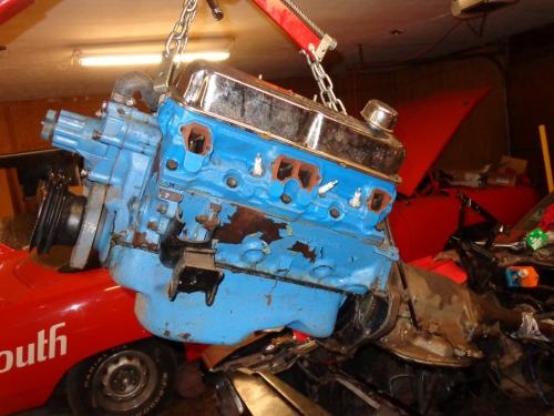

I use the same engine leveler that KrazyKuda used. I was doing it by myself and the leveler made it possible without help.
I also put a rug over the grill area. And...should have put one along the firewall. I nipped the firewall and scratched it a little.:banghead:

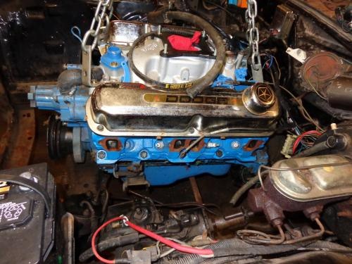

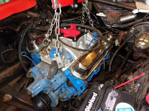

Carb plate. Put the 360 I built for my 69 Dart in with a carb plate, didn't remove the hood or remove the Rad, slipped right in.

Man, you are brave putting that in with the radiator in place!

LOL I had the PS, ALt and A/C on, never even touched the rad. Close, but move slow and all was well. Damn, I miss that car :(
Dang! I was thinking just that ... he still has all the accessories on and the hood wth!
that set up looked sweet
