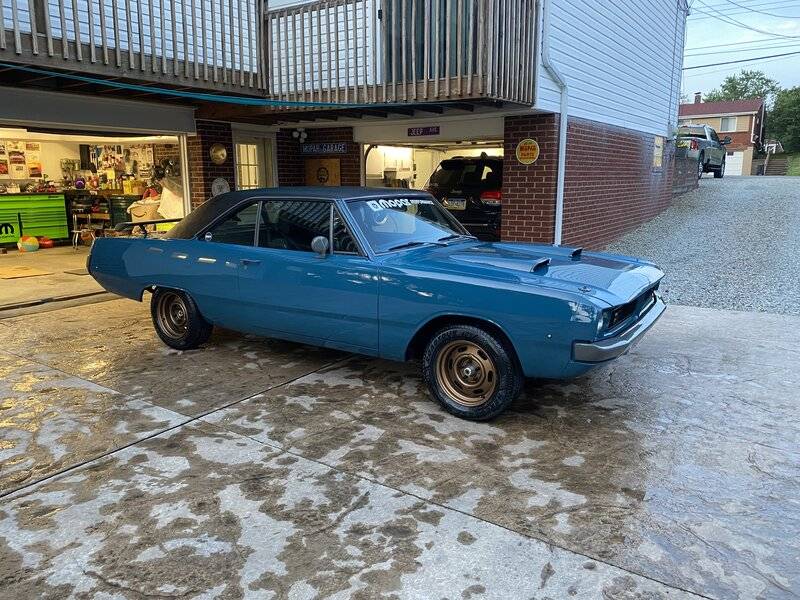

There is room around the hub, the wheel sits flush on the rotor.
Thank you sir!
Makes me really wonder about Wilwood’s instructions, but that looks pretty good to me, that wheel should be sitting flat on the hub based on that picture. Thanks for posting that! I will have to adjust my advice, because I’ve had it wrong based on Wilwoods instructions.
Thank you sir!
No problem, happy new year
This helps, I have been holding off since I could not get anyone that would post that they had a setup that did or did not work.

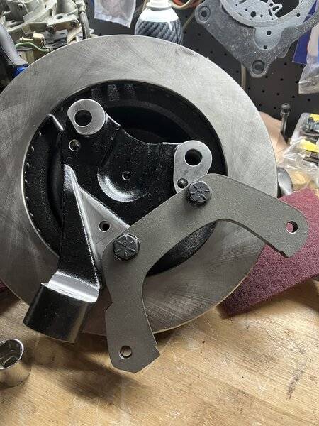

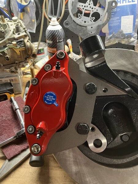

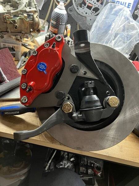

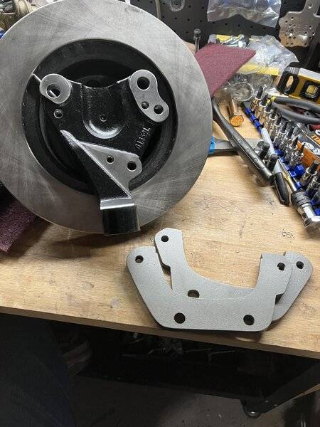

There’s another option, do what I did, I used cordoba 11.75 rotor and fabricated a bracket to mount the wilwood D52 caliper onto the Mopar spindle
