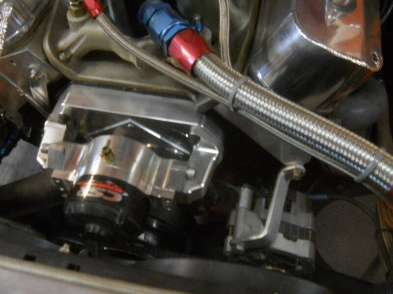

We are going to belt drive with a crank trigger ignition. Distributor on the front of the cam. I'll have a nice billet cover for sale when it comes off. My son is going to start making them on a CNC.
