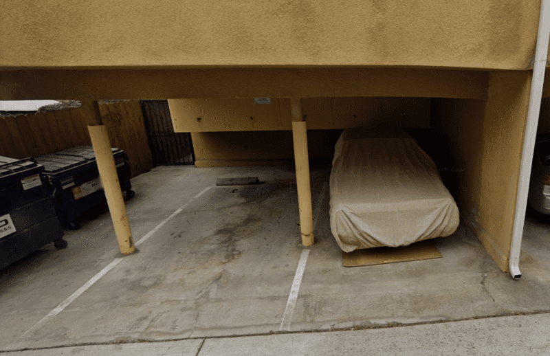

If i had a garage it'd be a beautiful thing. I live in an apartment with a stall in the back.. much better than most places around me here in San Diego honestly. Id absolutely have a grinder and all sorts of other stuff (i miss wood working the most).
Courtesy of google maps street view; the locked cabinet to the far right is the most garage i have.. minus my bedroom which has tool chests next to dressers:
(PS i found a bowling ball next to that dumpster there a few days ago.. its from the 60's and all shiny and rad. Trade you ball for i dunno.. GETTING MY CAR RUNNING? haha)

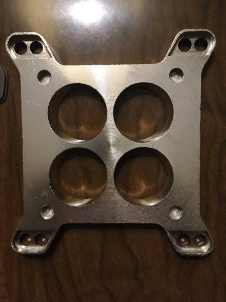

Ok...here's the plate I used many years ago, for just what you're doing. As you can see, the Allen bolt fits perfectly w/ no grinding req'd. Those are 1.25" bolts, but 1" will probably be perfect...

I ended up replacing the plate considering @dukeboy_318 stated he went through the same thing and it would pool gasoline in those holes (and finding the bolt was a pain and this just solved it quick and cheaply).

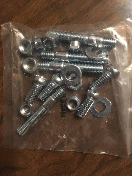

You'll see in the pic above that the kit comes with the bolts @65Val was discussing above. After replacing the plate with a new plate the carb STILL didn't work - it would start and surge and die. I thought after some tinkering for an hour that maybe the plate itself isn't perfectly flat.. it wasn't. I put two gaskets down between the intake manifold and the plate and one between plate and carb.. and it worked! Car started and moved under its own power. I am for sure having some adjustment issues for sure.. but I didn't mind.. finally functioned.

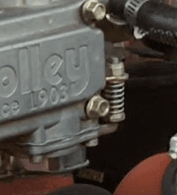

IF there's no fuel at first movement (65Val's test), this is the pump lever he was talking about.
If its the pump cam that Holley installed, all that should be neccessary is adjusting the spring loaded bolt so there is zero play at idle.
If the pump cam has been changed, sometimes its neccessary to reshape the arm (bend) so it contacts the cam where it will do good (upper arrow). Also make sure the lever is not contacting the throttle spring next to it.
If fuel is still not appearing immediately, then check valve (umbrella valve) could be damaged.
I think I know why MO mentioned power valve. If you get a part throttle flat spot at higher rpms, that would be a possibility for sure.

Perfect pics thanks Mattax - I actually tried to adjust that screw so there would be zero play against right where that red arrow is pointing to the arm.. I cant loosen it enough to make it have zero play.. I set up my phone and took a video of the carb when i was having the first aforementioned issue with vacuum and caught the adjustment we're discussing and caught that movement.. (ok cant upload a video clip so i'll take two screen shots.. one at rest, one with throttle - see below)
Whats not obvious is that the arm for the accelerator pump DOES move.. just not a lot.. and no amount of loosening will make it really change anything visually on that movement.. seems to always make TOO much contact

Well that's it then. There's a big jump in position between the green cam and some of the others commonly used. You have to bend the pump arm or you might have to rotate the cam position up. Some cams have 2 holes, others 3. Same with the throttle. it has two countersunk holes. So this allows several positions with any cam.

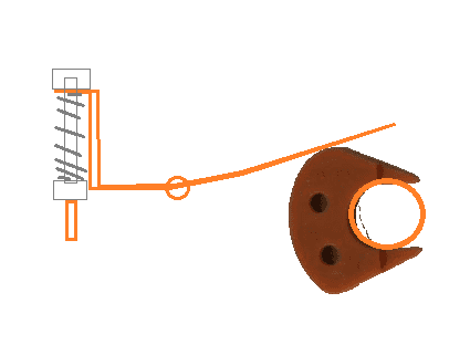

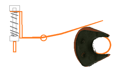

Orange is the 466 cam. 65 Val is talking abouyt the slightest rotation of the throttle should send some fuel out the accel pump nozzles.
You can see here how the shapes from begining to end vary, sometimes greatly.
from the photos it looks OK, but that really doesn't mean anything. If it causes movement when the throttle rotates, then fuel should move.
Sometimes the lever arm has to be bent a bit so the contact point is near the start of the lift.
In the drawing above, its probably fine, but some situation maybe bent a little flatter to so it will contact further right and have more initial lift.
its more of an issue when changing cams to one that is very differently shaped.
Good post Mattax...I was pointing out that when the pump arm is moved, it appears that the pump lever doesn't, as there is a space between the upper nut and the arm, telling me that the accel lever is jammed and not moving to activate the accel diaphragm.
