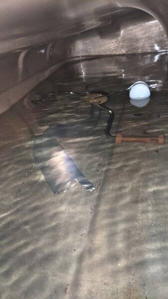

I shined a flash light into the tank and finally found the plastic from some duct tape from about 2 to 3 years ago. ( Long story, bottom line, don't tape things to wooden dowels with duct tape)
Since I did not think I had to remove the tank I left the 1/2 tank of fuel in the tank.
Had to syphon it out after I had the tank out and on the floor. (About 7 gallons with about 1 to 2 left in the tank)

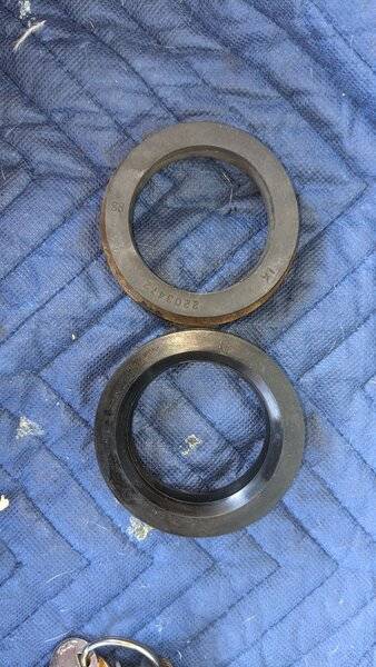

The new seal vs OEM seal
OEM seal measured about 2" id, the new seal measured about 1.9" id
Probably from old age?
The OEM seal was soft and supple
They don't make materials like they used to.
