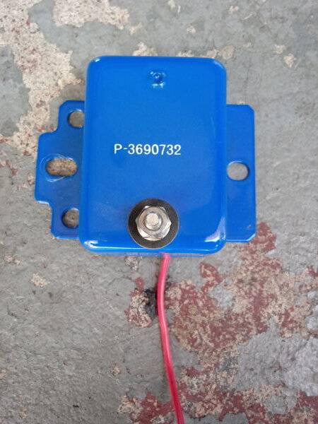

Nuthin. I got it fixed. Put a NOS old style regulator on it ant it's charging great.
I just told yall off the bat, I'm a dumbass with electrical and yet yall still turn it into a science project. I don't understand this ****. I need layman's terms ant it always goes sideways. But it's fixed and that's all that matters.
