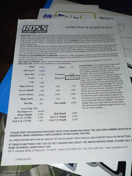

Scat 4 inch stroke with Scat I beam rods....
bob weight 1746........I think it is going to Rev...
Actually in 71 Duster

Hmm... now I'm thinking of a 273 block sleeved to a 340 bore with a 360 crank with the mains turned down... and being able to just keep pointing out the "273" cast into the side of the block to all the 5.0 blue oval boys...
i've known of 'class' circuit race guys that cheat by cutting the 273 casting numbers out of the side of the block and welding them into the side of 340 or 360 blocks.
Yeah, the 318 stroker would be my go to, especially if I didn't have a 340 block. It will do everything you want and then some. I would talk to Ken at Oregon about the hydraulic roller cam.
