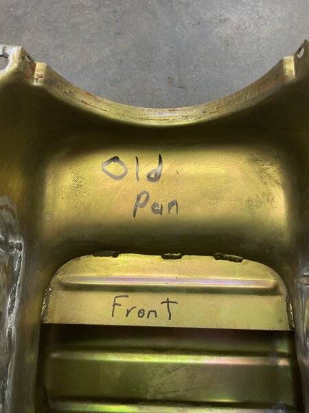

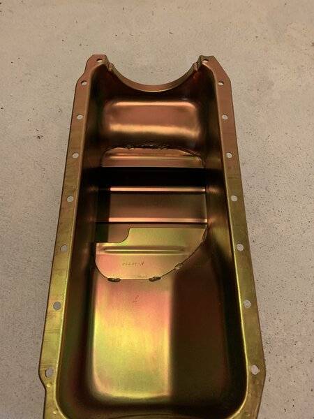

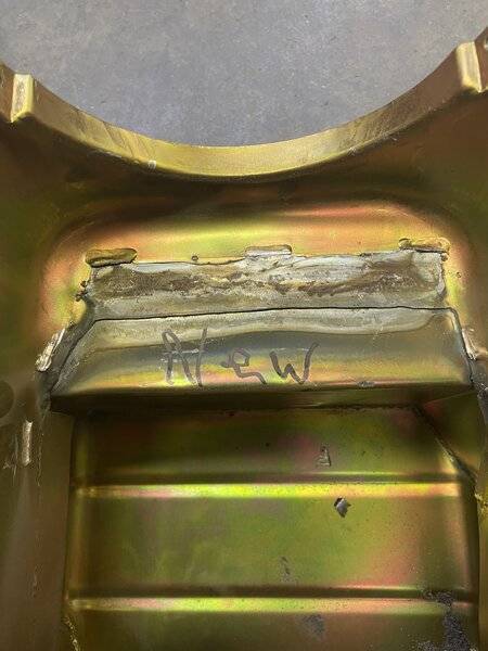

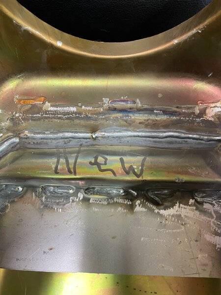

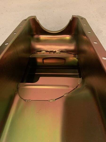

Your old pan has one style of baffles. Your new pan has a different style of baffles. But I have the same pan sitting on a shelf for two or three years and these baffles are different again. They are not the same as either of yours, although they still appear to sit lower similar to your old one.

At least yours is notched for the pickup and they lowered the front one right.

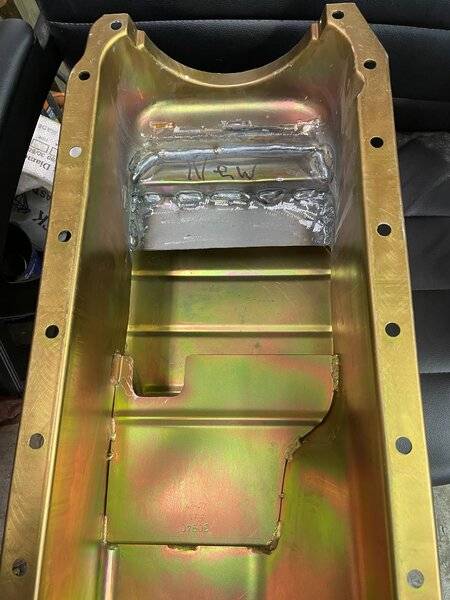

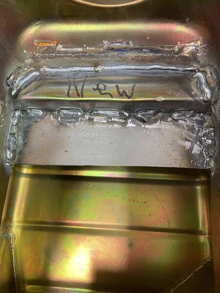

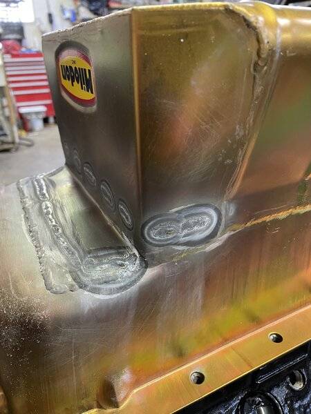

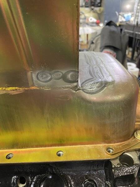

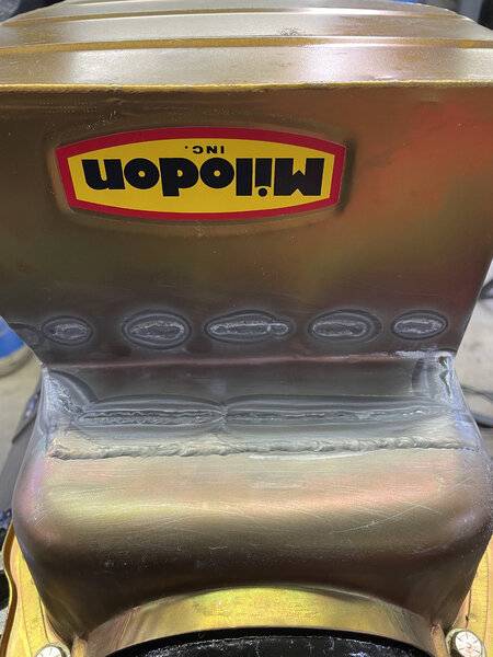

Well I called Tom at Milodon at 3pm PA time as he requested. He didn’t get a chance to check my pictures out as he said he was working in the shop. He said he would reach out to me later in the day. If not I will call him tomorrow. I picked up a nice piece of steel last night a Tractor Supply and cut it to fit the front piece today. The sides had a gap because of the way they leave a flange in the inside of the pan. I welded it in and although not pretty filled the gap to help retain oil while braking on the top end. I also welded the overlay that was in the new pan but not the old pan that was under the plate when I took it out. I test fitted it and everything clears now. I even tried a oil dipstick and you can feel it skipping off the edge of the front plate and into the sump. That will work fine. Time to throw some gaskets on it and button up

Something tells me your pan came from the wrong factory in China and ended up with a Milodon sticker on it.
It’s a shame to have to do that to a new pan. Probably still had “New Pan” smell!

I gave up on those pans and now i purchase the Moroso deep sump 8 quart pan and cut a 1.75 band out out of it.. Then weld it up and use the milodon pickup tube. This is simple and easy and makes engine swaps easy. No modifications to the k member is required.

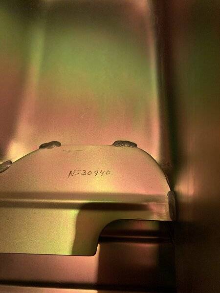

Yes, they welded the trap door baffle with the 45 degree in the wrong side. I cant get the other pics I have to upload. Keeps giving me an security error message.
I’m guessing over the year’s I’ve bought at least 5-6 (340) and (360) Milodon oil pans and never had an issue. Well I guess an engineer must have had some spare time on his hands and decided to reengineer their oil pans. What an idiot move. First off they lowered the windage towards the crank, forgot to clearance for the pickup tube and even made it worse by moving it into the sump areas further. Take a look at the notch I had to grind out for the pickup tube. Then once it cleared the front rods hit the tray because they lowered it too. I tried to ballpeen clearance it but I’m hooking up the torches to get it hot enough to do major mods. 300.00 oil pan and a day plus lost. View attachment 1715710833View attachment 1715710834
