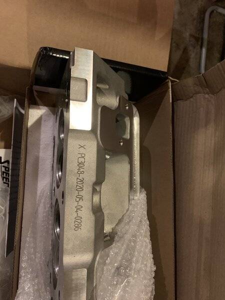

Having scorched Speedmaster several times for their horrid handling of my business in the past, it's only fair that I give then an attaboy when they earn it. Against all my better judgment I ordered a set of bare SB heads along with a stud kit. After a week or so they give me a call, making sure there's nothing hinkey going on as I'm shipping to a different address than my billing address. I confirm yes indeed this is me, and the shipping info is correct. The disparity between shipping address and billing address triggered a flag they wanted to check for fraud before processing the order. Thank You, Speedmaster. A day or two later I see the order processed, and another day or two I see the shipping info. The heads arrive on time and in good shape, and look gorgeous. I'll have my machine shop give them a quick look to make sure there's nothing unpleasant going on but the machined surfaces look excellent, the ports look very nice, and so far I'm a happy camper. The MFG dates on them are even the same day, 5-4-20.

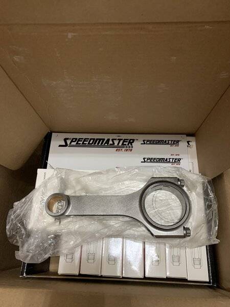

After a six day layover near Chicago, according to the tracking history, the connecting rods have arrived.

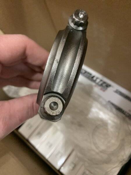

What is marked on the end of the rod bolts.(head) Are you going to have them checked out for things like center to center, out of round, are the weights pretty consistent, pin and rod journal sizing, etc. kinda curious how they check out.

I will try to get overall weights later today. I don’t have a setup to check big and small end weights. No immediate plans to spend money on inspecting them for dimensions, but will try get some measurements on my own here if I can. Quick check with a cheap dial caliper shows small end of one rod is about .985” so at least it’s correct application for small Chrysler.
Rod bolts appear to be generic; not ARP. See picture below for head stamp.

Had a chance to start looking at the Speedmaster connecting rods.
I checked the small end of two rods and using a set of new pins from KB107 pistons I get about .0005”-.0006” clearance, and they seam to be round within .0001” as best as I can measure with telescoping snap gauges and a micrometer.
I checked the big end for roundness but not for size yet. The big end seams to be .0001” or better for roundness with dial bore gauge zeroed.
Center to center length seamed to be 6.125” but this was just using a large digital caliper that usually does not return to zero when closing. It usually reads off by up .001” and I normally only use it for pushrods. So that can’t really be trusted for exact measurements.
The threads on the 8640 bolts supplied with these rods look kind of sharp on the peaks. Maybe cut threads instead of rolled threads, but probably fine for any cheap engine I will end up using these on. The threads definitely need to be cleaned, but instructions say that anyway so it’s not a complaint. They will get a good cleaning and further measurements when I finally use them, but who knows when that will be.
