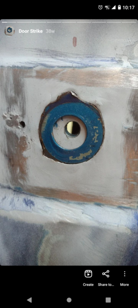

Will post a pic tonight. Thanks Its the driver side. Striker hole is a mess.
Here are some pics.
I have at part and the rest of the jamb but I would still do the AMD patch or whole jamb

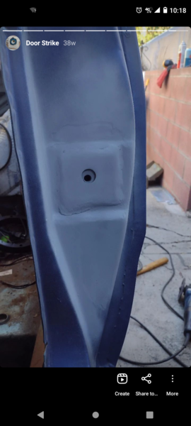

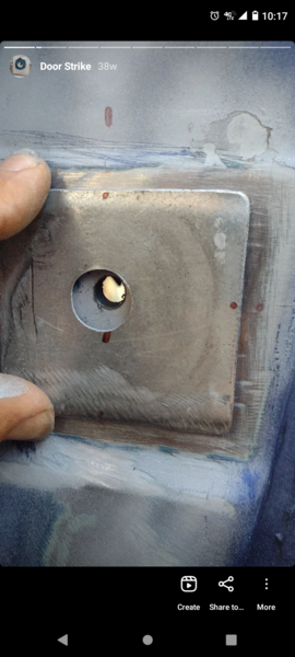

Being a convertible would make more sense to do a solid reinforcement. I've heard good about Dynamic posted above.
Agree on the solid reinforcement, there is a lot riding on that pin! The plate is very solid and contoured perfectly, no adjustments were needed before I welded it in.

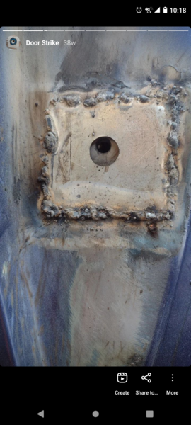

mine rusted out and broke in the exact same pattern.

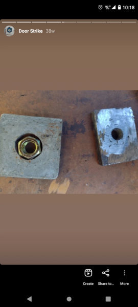

i couldn't find one either... so i made one...
please don't judge me by my flux welds.

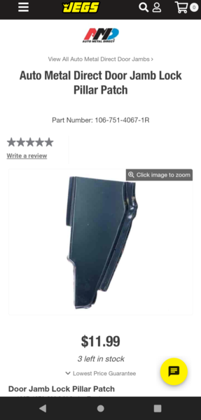

Cant seem to find the entire jamb on amd website. Anyone have part number?
part No. MP41268,
I was going to replace the entire door jam if I could. It has rot in the bottom corner. Could have sworn amd carried that part.
i think amd makes it but another reseller may sell it for them
this one isnt for your mopar but i think thats what you're talking about.
may be possible to fabricate if you had the patience and the original piece as a template...
Ok I was able to figure what they called them. Door lock pillar. No they dont carry them anymore.

i found them. part number 750-2067l and 750-2067r. on amd web site for 159.99 each. call stephens and they can bring them to indy.
