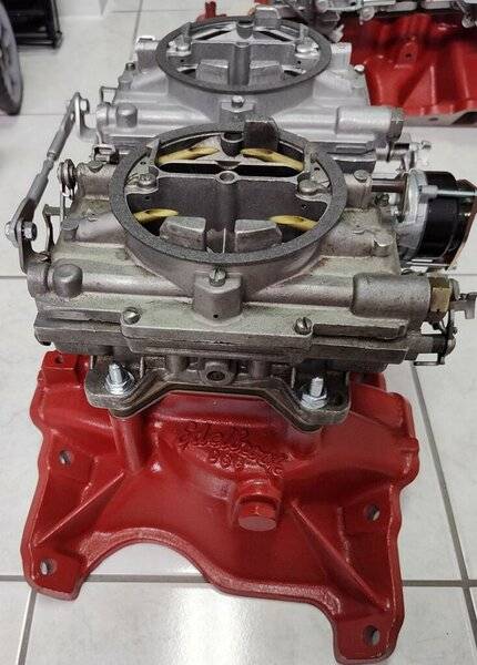

If you bolt the D64 intake to 360 heads, the pic below is how far out of whack the bolt angle will be. Pic was made with an Edelbrock D4B, which was made to fit the 64-65 273 motors like the D64 was. If you use a D66, the flat washer on the intake bolt will be at the same angle as the pad it will hit on the intake.

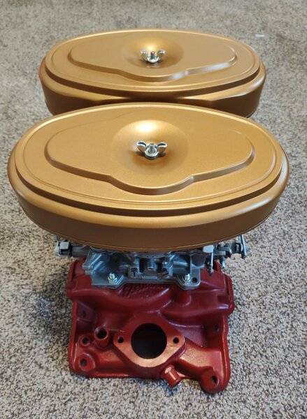

Here is my D66 with correct rebuilt AFB carbs, linkage, choke, etc and air cleaners that I bought from another member.
I opted for the gold air cleaners although chrome is correct too (just more expensive!).
This setup will be going in my 47 Dodge with a 70’s 318 and 42RH
