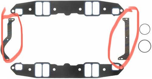

Just came back to this thread after a few days and appreciate all this info. Haven't had a chance to read through all the details but will do so this week when I get a chance to work on the car. Something here will most likely work so it's going to be trail and error at this point. On another note, the intake install instructions mention "do not use end seal gaskets." Is that really an issue if I use end seals instead of just a silicone bead?
I want to be clear what you are asking.
Do you mean the instructions suggest you don't use these I have “circled” ?
And make sure you remove the locating pins in the China wall. I bet the aftermarket intake doesn't have holes for them.
No, the Edelbrock intake instructions says not to use them. Gasket set, which includes the end seals says nothing.
I know most say not to use them. The world won’t stop if you do or don’t. It’s easier without them, but I use them on the oem intakes, on anything else it’s a test fitting dry, how much from the wall rails to intake, checking if the port alignment will be good and making a determination.

I just always used the front and rear gaskets with “goop” where they meet the intakes and to kinda hold the front/rear in place when dropping the intake in place, with not a problem.
Also heard of people just using rtv on front and rear also with no problem.
I never had the instructions in my hand so thats what surprised me that instructions say don't use.
