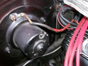

Checked my engine ground,didn't look to good.
It's fastened to the blower motor,good enough ground?I cleaned under the new terminal down to bare metal.Other end is fastened to intake bolt.Nasty little snake all broken and bare,NG.:-D
