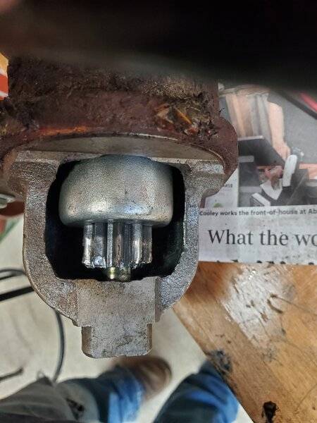

I had pulled the starter before turning over by hand, so I bench tested.. The starter spins, but the gears resting position is where you see in the photo..and that can't be right. Is this a known issue and can be convinced to reset? Or is this in need of a rebuild? I see them online at $300... Yikes....
It's probably just sticky. The flywheel kicks it back in when the engine starts anyway.
Yes, it's normal. This isn't a solenoid-shift starter drive, it is a Bendix Folo-Thru starter drive. The drive pinion you see here rides on a helix. Inertia flings it forward up the helix when you activate the motor, and it latches into the forward position. It stays in that forward position until the engine starts and overdrives the pinion fast enough for its flyweights to fly outward by centrifugal force, unlocking the pinion from its forward position and driving the pinion back down the helix.

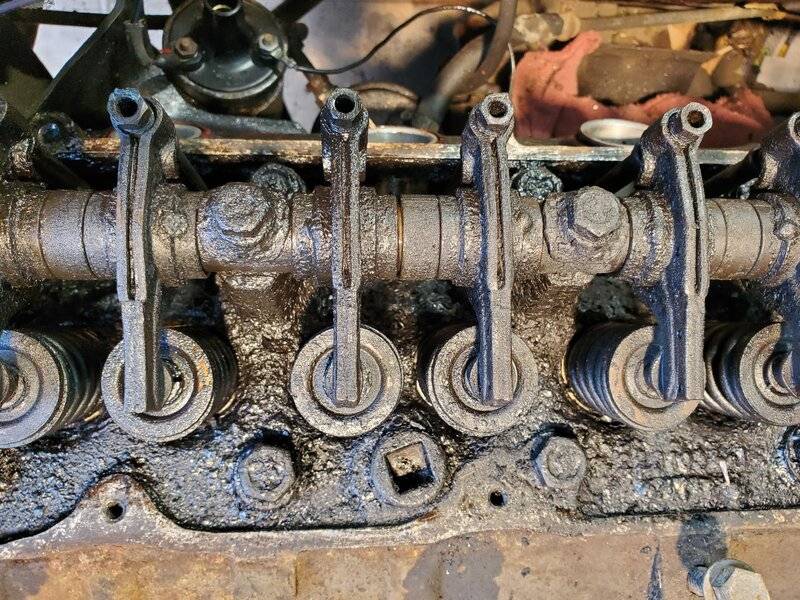

you got the valve cover off? if not, yoink that thing and have a look to see if the valves are moving or you got one stuck (or dropped) that's holding up a full rotation as the piston contacts it.

I agree with removing the valve cover. Then, just LOOK at all of the valves and see if there are any "short". That would indicate a stuck valve and might be what the piston is coming up against. If you find one, take some GOOD penetrating oil and spray into that spring and try to SOAK the valve stem where it goes into the guide. Let it sit a while and then come back, loosen the rocker adjuster, remove the pushrod (probably bent), push the rocker out of the way and tap the end of the valve stem and see if you can free up that valve. Tap on the VALVE TIP, and NOT the valve spring retainer.
Crank needs to go around twice to run through one rotation of the camshaft. So you may have a valve problem and are hitting it going backwards but haven't gone around twice to hit it rotating the other way. Get it?

Crusty, but nothing obviously broken, and moves as it should when I turn several rotations. Counterclockwise rotation still stops with a clunk, I'd say from the back of the engine or the trans...
