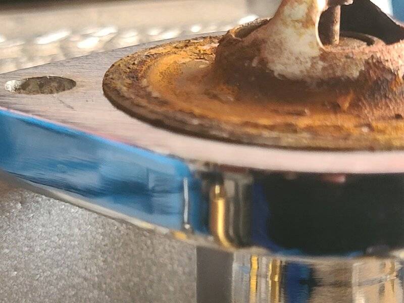

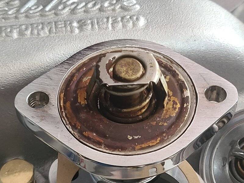

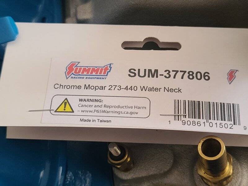

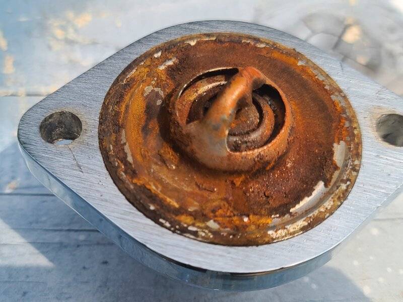

Well oops! It's made in Taiwan, but I'm sure people will say Taiwan and China are the same thing, which is somewhat true I guess. I changed the title, just incase.
Anyway, it took me 30 seconds with the rotory tool to fix the issue and now the stat fits perfect in the recess.
We will see how the cheap water neck holds up over time.

I would run that across a flat surface with some emery paper and check to make sure it’s flat and knock that chrome off the sealing surface.
Your problem starts with the chrome t-stat housings, everybody knows they are junk. OE housings are the way to go. No trimming, grinding, 3 pages of shenanigans.
Bolt on and go.

I will fully admit I might do the same thing, but the issue with doing it this way is that Summit never finds out their part is wrong.
While a pain in the ***, the better bet would be to return it. That way, the problem gets noted. Maybe one return doesn’t change stuff, but a bunch of returns might. Summit did after all stop selling Speedmaster parts after their recent snafu with copying other companies parts without permission.
Like I said, I’m guilty too, I’ve totally modified parts rather than return them because it was faster and got me back on the road.
Throw it away.
Better to send it back and make the manufacturer eat the cost.
You are wrong here. You can give every product Summit sells a review. I know I for one read them.
