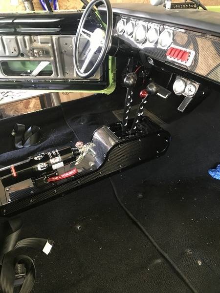

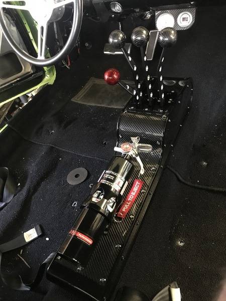

Fabricating a shifter console
That turned out awesome, wish you were closer would see if you could make a console for me :thumbsup:

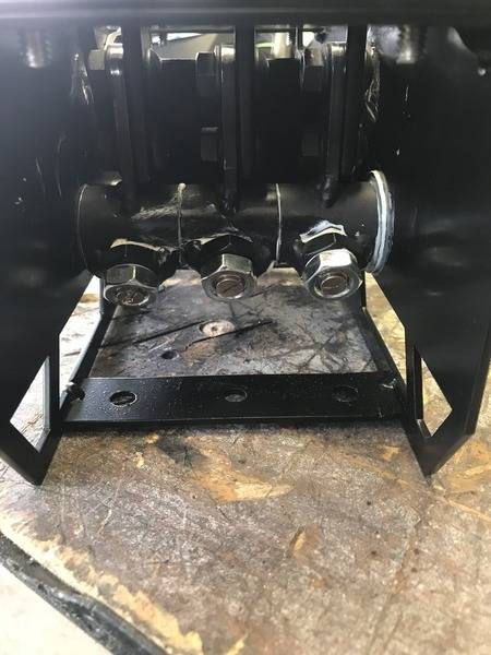

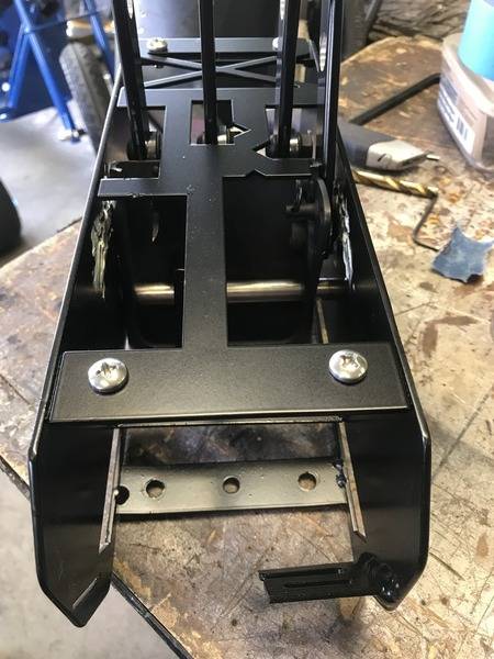

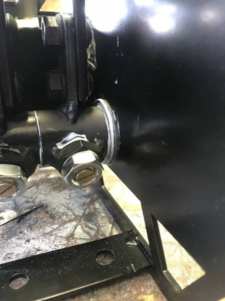

So here are the inner workings of this shifter. Very very simple design. I ordered shin washers and took up all the side to side play. Now levers don’t rattle.
Then I painted my shifter/console mount

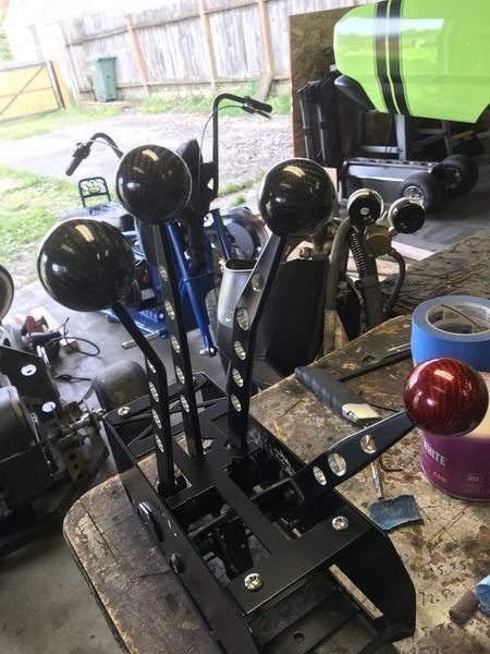

Then I worked on my cheap eBay shift knobs. They are threaded for 12mm so I drilled heli coiled them with American threads.
That looks really cool. The lever with the red knob i presume is for park, neutral, and reverse. Its got style, with a high emphasis on function. Basically saying no bullshit here, just like an aircraft cockpit.
