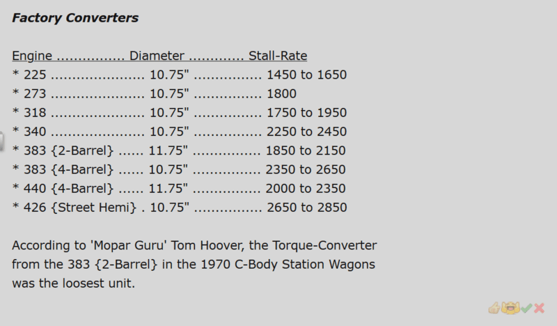

In a recent post Duster Daddy mentioned a Factory High Stall used on the 1974 Duster 360 can anyone give me any info on this? Also was there a high stall available for the 340 and if so what was the stall??
Skip
I found this in my files. Probably picked it up from FABO........Lol like most things!

From Chapter 8 in the highlighted book:
Interestingly, the 1969 340 and 383 converters were the same part number and they had factory-rated stall speeds of 2250 to 2450 RPM and 2350 to 2650 RPM respectively; the HEMI® with the same basic converter had a rated stall speed of 2650 to 2850 RPM. This again shows how the same converter (same K-factor) acts very differently depending upon input torque.
One publication states that the common factory 11.75” converters have a K-factor of 115K and the 10.75” converter used in the 383 4 BBL, 340 4 BBL, and 426 HEMI® 2-4 BBL was a 135K. The 340 and 383 and HEMI® all had rated stall speeds around 2400 RPM. However, other publications state that a 145K rating relates to a converter that has a 1900 to 2100 RPM stall speed, a 166K is 2250 to 2350 RPM, and a 175K is in the range of a 2400 to 2500 RPM rated stall speed. Clearly, there are a lot of K-factors and stall speeds differences. Fortunately, if you have the torque curve for your engine, and a K-factor for various converters, you can calculate and compare converters to determine how your vehicle will respond.

Chrysler used at least three different converter ratings through the years. There was the standard stall which was generally from 1200-about 1800, there was the factory high stall, which stalled "about" 1000 RPM higher and there was also a factory low stall for trucks. I've seen and held all three in my hand.
Just because you may not necessarily be of the opinion that Chrysler didn't offer something, let's not spew incorrect information for members that might not know what the actual reality was, ok?
Read Tom Hand's post #11 above. He is a noted Torqueflite authority and author of the book he pictured. I believe he would know.
This was to my point. The same converter behind a different torque curve will produce different results. An 11.75 inch case isn’t a high stall anything. Maybe in 1970 certainly not today.
But saying Chrysler never offered a high stall is anything but correct. They were stamped "Hi Stall" and had different part numbers indicating such. They were the factory's performance converters.
