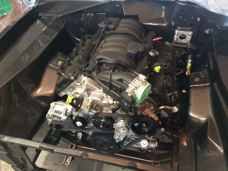

Still haven’t even started them. Ran into a few hick ups install the new engine. Now dealing with steering issues ,and power steering pump. Mopar power steering pump produces too much psi for my power rack. Still making headway on the project, taking longer then I would like.
