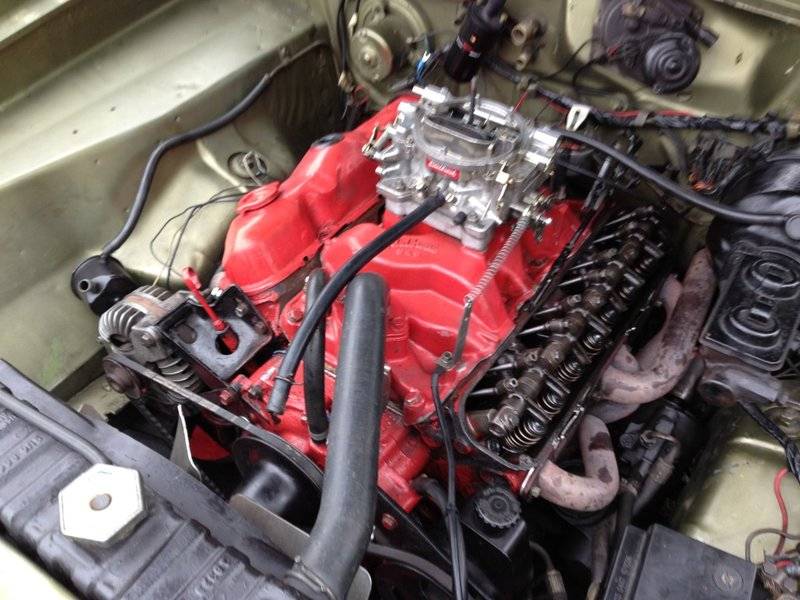

Finally, my first 360 and goals for it! I'll be asking a lot of questions.
Are those double springs or single? Really hard to make out on the image...
From what I could tell yesterday they are single, but I agree, some of them looked like they would be double. I'm gonna give them a closer look.
Alright. My plan was to have the heads milled some. After looking around for shops and getting quotes that would cost as much as getting speed pro pistons here in Sweden. Would it be wiser to get the pistons? I've never changed pistons before so I dont know what tools and work it requires. Im not scared to do it, I'm sure I will manage if I do the homework and go slow. Main concern is budget, and will it be worth it considering my goals for this engine as stated in post 1?
Do you have more info on that cam? And how you tell from the valve springs?
If everything is on your motor is still factory stock, then the dampers on valve springs indicate it is a hi-pro engine. I'm not sure but I believe the hi-pro 360 used the same cam as the 340 which is .430/.444 lift 268/276 duration. Having said that this motor is over 40 yrs old it's hard to be certain if anything has been changed on since, it does have an aftermarket intake.
