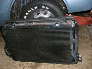

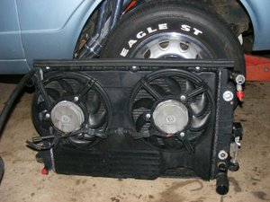

Yesterday I went to the wrecking yard in search for a new aluminum cooling system/tranny cooler.I ended up pulling this from a 200? Audi V6,it,s all together in one piece(grabbed the mounts also)I may have to do some rigging it in but will make it work for the $75 I paid.I,ll be turning the condenser into my tranny cooler and hooking the fans up to a relay.The car is coming along good,batterybox in drunk is done,also new 3/8 fuel line.Here,s pics of the cooling system.Hmm?Won,t let me load pics?I,ll try later.

Thanks MeMike,I,m definetly ahead of schedule!I can,t load pics today for some unknown reason?Will try again later.
Good ole hotrodding at it's best. Pulling a rad from an Audi???!! and making it fit is very cool and waaaay less money than buying a new one.
Very cool petty!8)

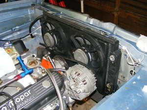

Sounds like a plan. I wired my electric fans to a relay with the thermcouple mounted inside of the fan shroud against the radiator. Now the fan will run even after the car is shut down like a modern car. It is looking good pettybludart.
Lol! I saw the pics on the other page so it's a moot point but thanks anyways,lol:profilel:
Did you wander round with tape measure in hand until you found one "close enough"?

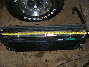

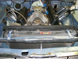

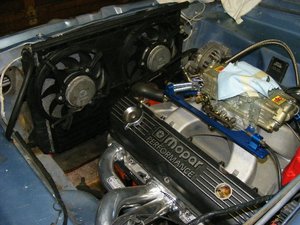

Yes Needaresto,I brought the tape measure til I found the right length and depth.Well,I basically have it in the car.I still have to hook up a relay and mount the condeser/tranny cooler on the front side(was to thick all together)I had to trim the lip on the frame at the front,but the mounting brackets for the side of the rad fit perfect(sitting ontop of the frame)I don,t think I,ll be having any overheating problems.8):cheers:

Hey Petty that looks like it was made for the car! What a good score..:cheers:

The radiator looks good in there. Bet you have plenty of CFM to keep that beast cool.

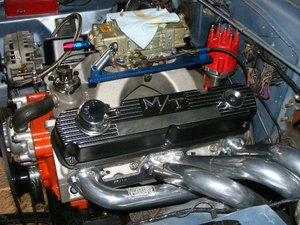

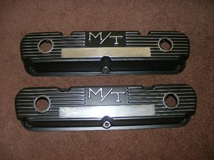

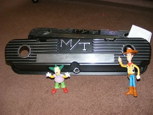

My M/T valve covers just showed up from Leanna(PCS)they look awesome!They will fit in with the old skool look I,m going for.Time to sell the MP ones.Woody gives a thumbs up!LOL

After reading your other thread tonight, I just have to ask: Which woody???
<< duckin >>
Glad you like the work Scott! I appreciate your business and look forward to dealing with you again in the future. :-D

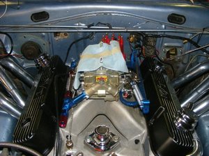

Well moving along..I installed the 4 post to 2 post adapter(not enough difference)so I,ll be opening up the master hole on the firewall and moving the master to the top 2 posts.(member the67fish)has shown me pics of his work on his 67 Cuda race car.I,m gonna start the cage today after customizing my race seat install.Lots of measuring to do,it won,t be long now to first fireup!
