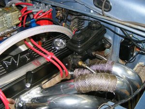

Well moving along..I installed the 4 post to 2 post adapter(not enough difference)so I,ll be opening up the master hole on the firewall and moving the master to the top 2 posts.(member the67fish)has shown me pics of his work on his 67 Cuda race car.I,m gonna start the cage today after customizing my race seat install.Lots of measuring to do,it won,t be long now to first fireup!

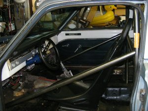

Hey MeMike,this 8 pt. cage from S&W Racing($179) came pre-cut and notched,nerelled?Just abit of trimming,fit and weld.Will be measureing twice before welding.:read2::cheers:Wish you were here to share a 12 pac and talk turkey!LOL:-D

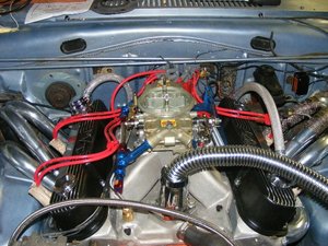

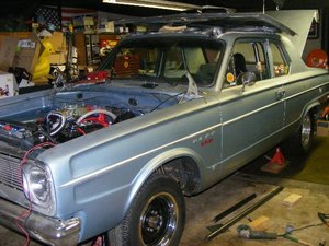

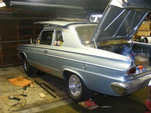

Well the past couple days I got a bunch done.I had issues with my master cyl. even after getting the adapter(4 post to 2)so I oped up the hole and bolted up to the top 2 studs of the 4 post(stock).I got my race seat installed,was a job and a 1/2 do to my short ***!LOL.Also got my cage started and should be able to fire up next week.I,ve been holding off wiring up my MSD til the car is complete.Some pics for your enjoyment!...=P~

I am soooo glad you got your master cylinder in :cheers::cheers:
Looking good!!! I bet that seat location will fit me just fine =P~
You are moving on petty 8) That is going to be a VERY nice 66 Dart =P~

r you keep the rear seat pettyblue, why are you placing the main loop so far forward, go to the hump area.....would give much more clearance and easyer entry and exit....

I,m only 5.8 and the seat has to be a minimal 6 inches from the backbar(also attached to the seat)as rules state when going faster than 10.99.Will I go faster?Still to be seen,but plan on running mid 10,s with this engine/tranny combo.I,m sure I,ll start out in the mid low 11,s til getting the feel of the car.I,ll be finding out this month hopefully!I have very minimal stuff left to do.:cheers:
