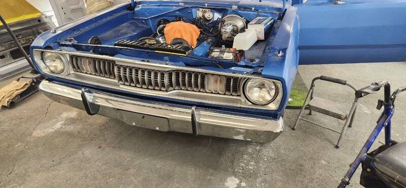

Shop needs to run the bolt out of the center of the 90 degree oil filter housing, pull housing off engine, then reinstall facing rear ward. I would order a new seal gasket kit cause builder may have skimmed RTV on gasket.

Ok. Thanks a lot. I will tell him that! He said that I can do it when I do the first oil change, but another person on here was saying that he doesn’t think the exhaust will even be able to be hooked up in the location it’s currently in

I believe the '71 340 pass side exhaust manifold had a center outlet which means good chance exhaust won't clear. And once exhaust pipe is on it will be much more difficult to re-orient that 90 degree adapter. My two cents its simply not acceptable having it installed completely wrong and should be corrected while exhaust pipe is off. And tell shop you are not a mechanic and need them to correct the issue. They should have flagged that issue PRIOR to dropping in the engine being you said they are a mopar shop have a bunch of Dusters laying around etc....

Thank you for the message. Ya, I agree 100% with you. Crazy to me that an engine builder would install it on the wrong way, to fit a temporary shipping crate, so that it would later have to be switched around….possibly requiring a new gasket….and I’m assuming dumping a bunch of oil out of it, in the process
A “mopar” car builder definitely should have caught it for sure

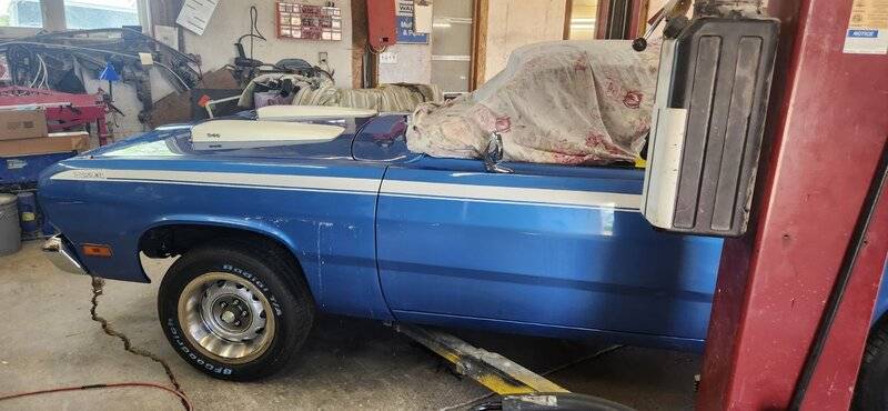

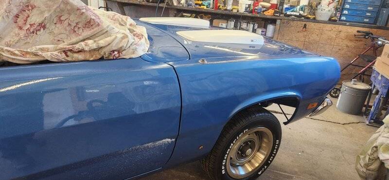

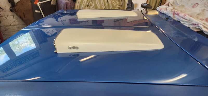

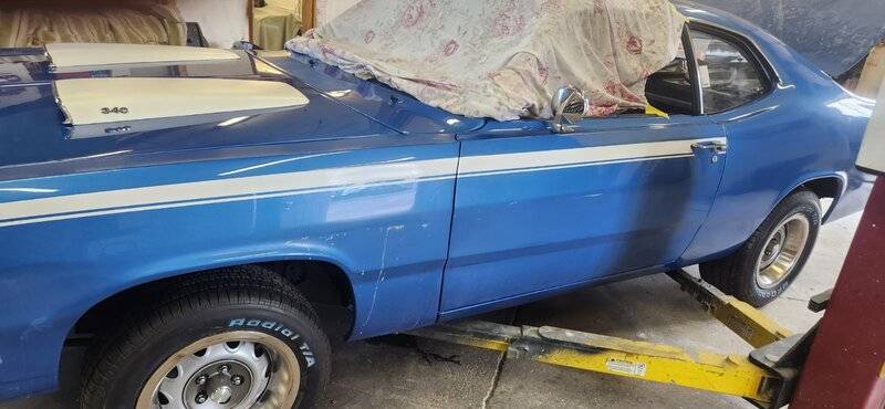

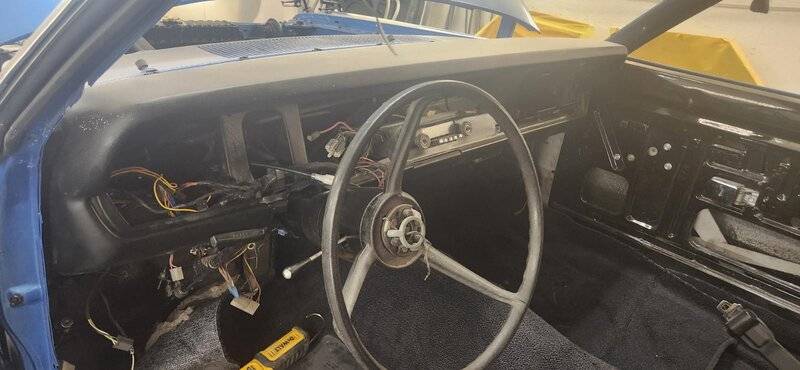

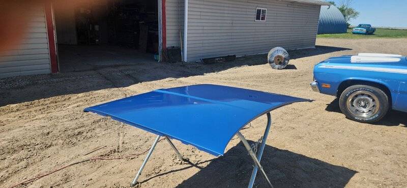

Hey guys. Sorry I haven’t posted in a while. Progress has pretty much stopped at this point. Going very slowly. Frustrating. Here are a few pictures
Great stuff! It will feel awesome having it in your hands again regardless how long the delays have been!

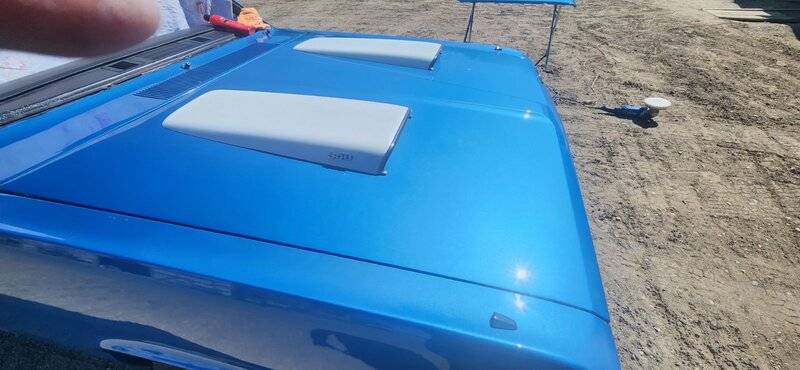

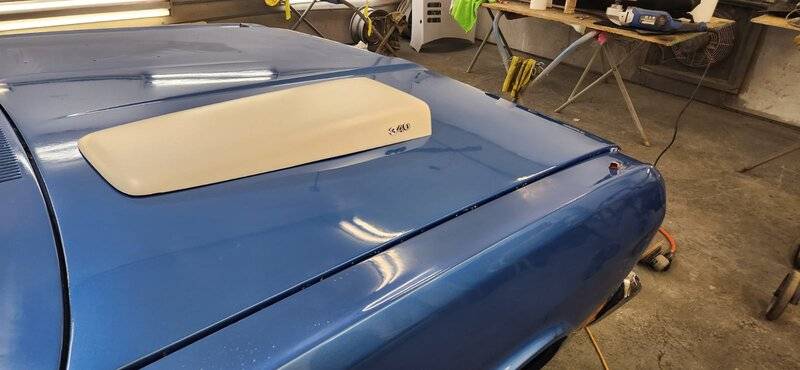

Hey guys. The colour really comes to life out in the sun!
Also, I’ve had bigger tires installed on the car and the rears only have 1/4” of clearance. Any recommendations on spacers? Thanks!
Beautiful color!
I'd drive it and check the tires frequently to see if they get chewed up. If they do, as long as the wheels aren't also very close to the spring, replace the tires with something 10-20 mm smaller. Using spacers may require new longer lug studs, and will of course push the tire closer to the quarter panel. Do you have lots of clearance to the quarter?
Beautiful color!
Thanks. I only need 1/4” spacers. I really like the look of a bit wider tires. I only went slightly wider, so I would avoid stressing the studs. Just can’t seem to find much info on spacers. I’ve found some universal ones that I may give a try!
I pick the car up soon, so I’ll check clearance to quarters. I think there’s lots
1/4" will double your clearance, so that's good. Just be sure you have enough thread engagement on your lug nuts.
I had a similar amount of clearance on my Scamp, didn’t have any problems and therefore didn’t buy spacers.
Great to hear. I’ve ordered some 1/4” spacers off of Amazon. I’ll see how they look and work. Maybe I won’t even need them
