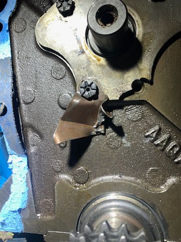

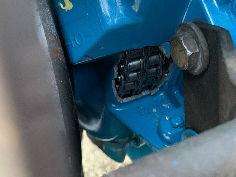

This engine was put together by an engine builder friend of my Dad’s (not a Mopar guy).
He showed this to me this morning and it happened last night. He haven’t seen this mess in person.
Any guess what happened?
I asked Dad if his builder degreed the cam. Nope.
Since I have a tendency to hoard I was able to give dad a new timing cover, cam retainer plate, oil slinger, and a Blueprint harmonic balancer.

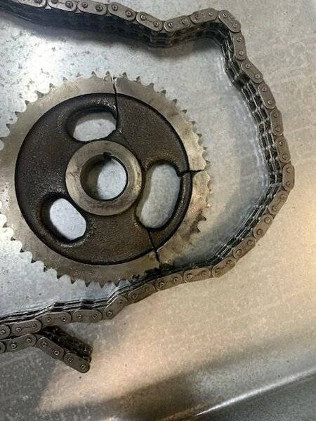

Yikes, had to be very abrupt to break the parts like that. Gear, chain, cover and even retainer. Were is the bolt and the piece of retainer. If it was the bolt loosening and jamming into the chain somehow, you would think there would be marks on the gear from interference. It would be interesting to let us know what you and your dad find out what the cause was.
I agree with 72B&B, no Loctite on the cam plate bolts. Bottom one walked out, trashed the gear and probably jammed between the chain and sprocket or the chain and timing cover and blew the side of the cover out.

I believe the timing set and balancer were fine. Most likely what 72BluNblu guessed for 800.00

Shouldn't the bottom left bolt with hole be in top left? Not that that was the issue.
What bolt/washer was used to retain top gear?
Actually, it goes in the top passenger's side hole. That's the hole that's open to the intake valley so oil can drip out......if you're lucky.
