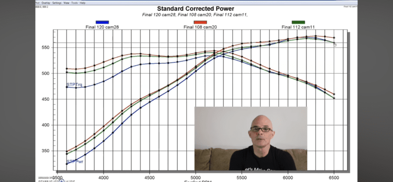

How about some dyno graphs from an LSA test Richard did. Notice the amount of change between the 3 cams, nothing is life changing here.
Between the (Red) 108 & (Green) 112?

That 120 LSA takes a beating!!!
Look at the rpm scale, and imagine the car has a 4000 rpm (or more even) converter in it.
This engine wasn't that sensitive between 108 vs 112 doesn't mean it holds for all combos but bet most would react similar, be interesting if he went even tighter with 100 & 104 see is the gain stops or breaks even or even starts losing bottom end.
Usually on a more serious effort you’ll see that huge lsa carry a bit more (longer) up top than it did in that test. I think that was more a function of a relatively mild combo running out of cylinder head as they all roll over about the same spot. Maybe some valvetrain instability happening there as well.
